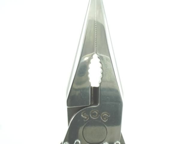

Here's a closeup of the SOG.

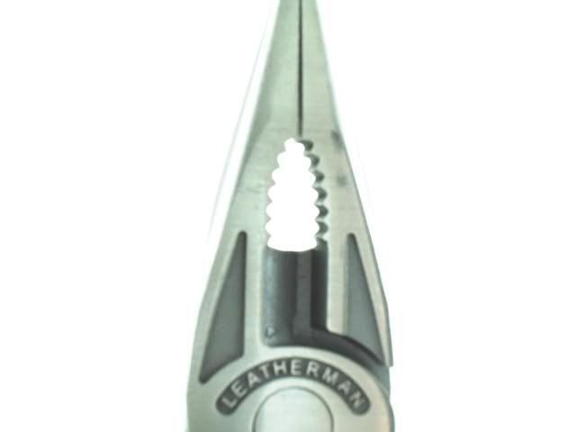

Here's a closeup of the Surge.

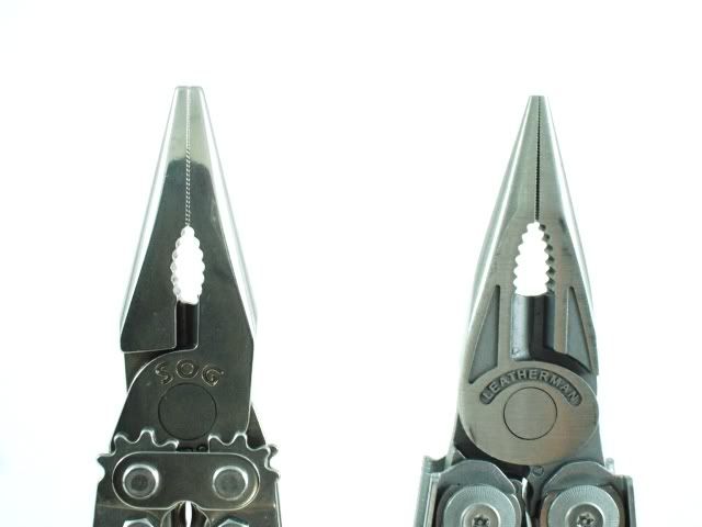

Notice anything different?
The shape of the opening on both tools is different, as is the size/depth of the teeth.  This doesn't seem to be that big of a deal, until you get a rusty nut between you and finishing a job.  While SOG's compound leverage helps, the small teeth, and round opening do not.  I've found when trying to loosen stubborn nuts that the pliers will slip off no matter how hard I squeeze.  With the Surge, the slightly deeper cut teeth aid in gripping the nut, and the shape of the opening fits around the nut slightly better.
