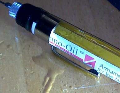

A quick warning to anyone about the little plastic tubes that Nano Oil comes in, they split :(
I believe they sell a more robust applicator and this is probably what they should be supplied with.

Thus far nano-oil is doing what it says on the tin for the last 5 years, highly recommended ;)
