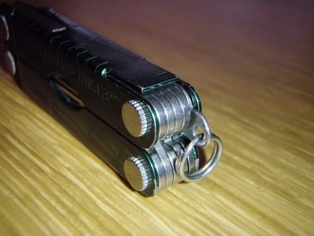

So I'm working on a micra. These were sent disassembled. Could someone snap a photo of the tools in their proper position please. Include where the lanyard ring sits. Thanks.

Alright these are the only ones I have from the other thread. Hope this helps. i will look around on the net to see if I can find anything else.
http://forum.multitool.org/index.php/topic,31123.msg519010.html#msg519010
I'm the milk man!
us Offline captain spaulding
    • Posts: 20,793
Re: Micra positions.
Reply #3 on: October 02, 2011, 06:16:50 AM
I'm the milk man!

I took some pics with camera on phone but they are a little big to attach here.
It basically goes:
Lanyard
Tweezers
Phillips
*dividers*
Caplifter
Other side:
Nail file
Flat driver
*divider*
Knife
This is top to bottom with "pats pend" side up but you'll be able to see based on the tweezers.  Let me know if you want me to email the pics.  Or I might get around to posting them somewhere and link them...

Just an FYI to everyone out there. There is a very very small washer between the nail file and flat sd. It's there to keep the tools from dragging. I found out the hard way. Thanks Grant for the info.
Sorry I forgot to mention that. I noticed it when I tore it down, but forgot to say anything. Sorry for the extra work.  :-[

No problem. I noticed it right away when a little more tool clumping than normal was going on. Then I thought, that's where that goes! ;)
