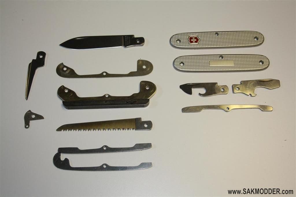

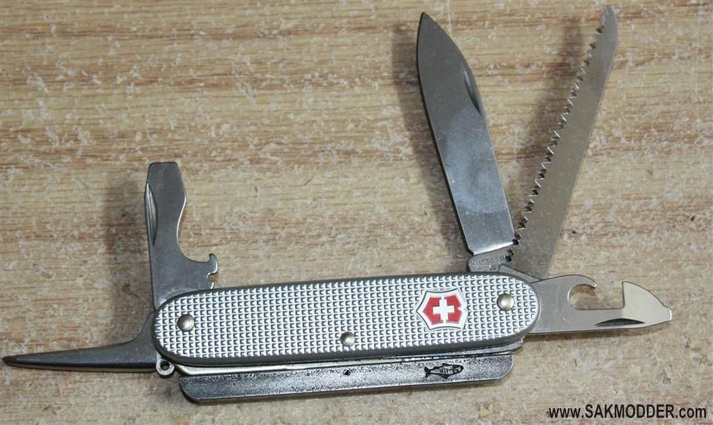

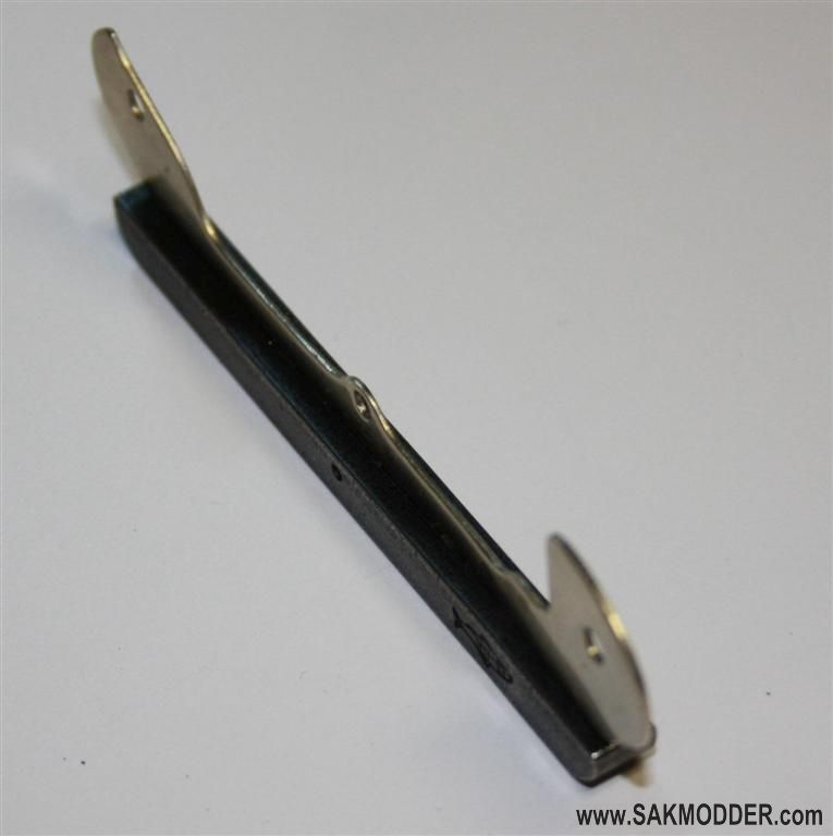

ca Offline Syph007
    • Posts: 9,842
  • SAK Surgeon
Reply #192 on: June 20, 2012, 09:10:54 PM
First time I've taken one of these apart.  I was curious to know how the firesteel was attached.  Its just a custom shaped liner with the firesteel pinned to it.

us Offline nj2656
    • Posts: 145
Reply #193 on: June 20, 2012, 09:56:58 PM
Looking forward to having a Bushcrafter the way it should come. The red is a great color. Can't wait to get it back.

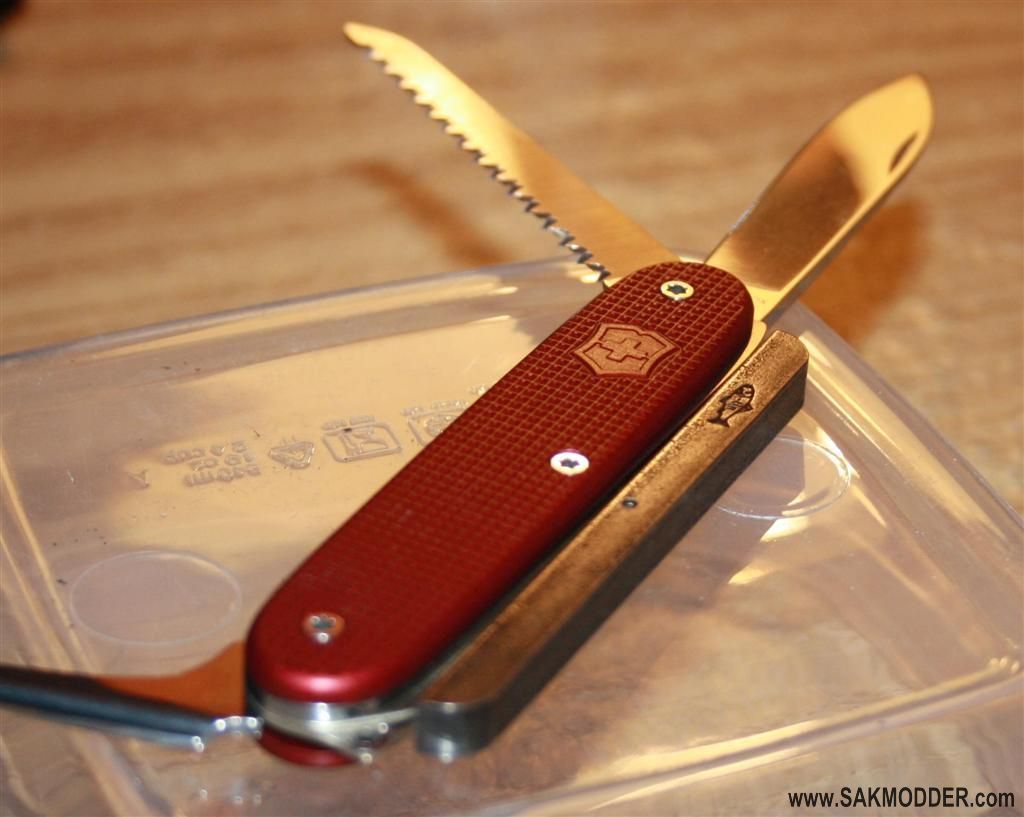

Reply #199 on: July 05, 2012, 04:26:35 AM
The red is my favorite too, and they were the first color to get deployed tonight.
Here is the bushcrafter minus opener layer with red scales.

    • Posts: 37,691
Reply #200 on: July 07, 2012, 01:01:26 PM
That's a superb model Syph. :salute:
us Offline nj2656
    • Posts: 145
Reply #201 on: July 07, 2012, 05:25:11 PM
 It started as my +B Firesteel Farmer. A great knife but I really wanted a Bushcrafter. The firesteel makes it a true Bushcrafter. Hope to have a long modding relationship.

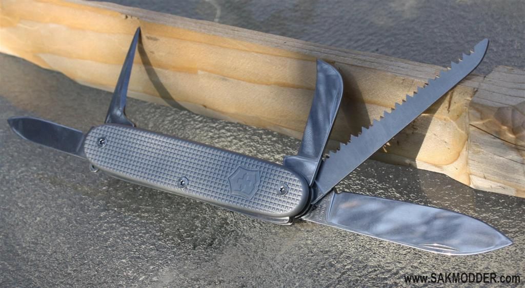

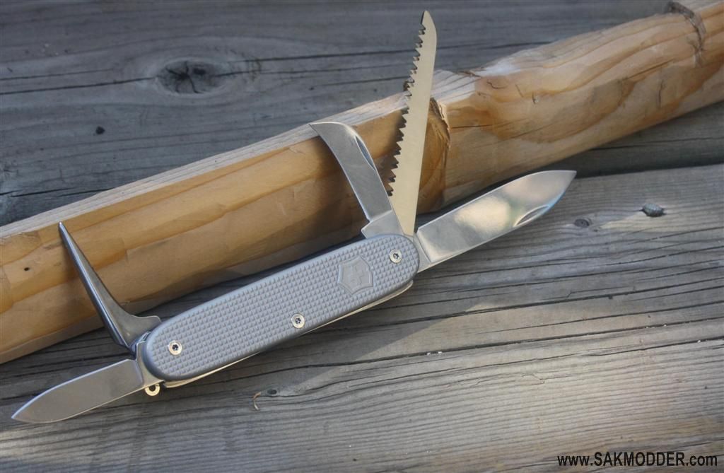

Reply #206 on: July 13, 2012, 01:13:11 AM
Alright, things just got weird and that's coming from me.  :pok:   :D
Ok, maybe I was overtired, but it was funny to me at the time.. LOL.   :D
Now.. for something different.. wait.. it's.. not an urban pioneer!
I had a request if this could be built, so I mocked this up tonight to make sure the parts fit together.  I have no clever name, but whittler something.  Its a harvester with small blade instead of cap lifter. I wanted to try out my natural anodized scales since I think they are beautiful, but maybe I should name them Titanium gray, like Vic does so they sound more exciting than natural hard anodize...  :think:
Anywhere here it is.. a fist full of blades and a saw.
With my other scale color options for reference, and a stock vic solo.  I really like the look of this one.

nl Offline Waterlander
    • Posts: 501
  • Don't follow me, I'm lost too..
Reply #207 on: July 13, 2012, 01:25:51 AM
Now that is a blade setup I like. Ubercool.  :tu:
us Offline bushidomosquito
    • Posts: 660
Reply #208 on: July 13, 2012, 02:35:47 AM
Beautiful. I had the same setup in mind even with the small 91mm blade (but the pruner ground down to a Wharncliffe for better whittling use) and the Bushwhittler was my favorite name for something centered around carving and sawing.
But I couldn't make the small 91mm blade sit high enough to get to the nail nick. How'd you pull that off?
Sent from my Glock 23 using Doubletaptalk
ca Offline Syph007
    • Posts: 9,842
  • SAK Surgeon
Reply #209 on: July 13, 2012, 02:46:40 AM
You have to flip the opener layer spring around so the longer part is on the small blade side and that props it up just enough to get to the nick.  It's still on the wrong side, but I can open it without having to open the other tools.  The pruner blade sits a tiny bit lower than so I had to change that profile where it meets the spring to get it to angle up a bit more.
