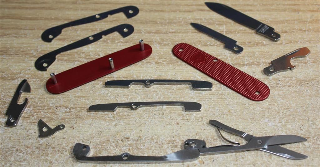

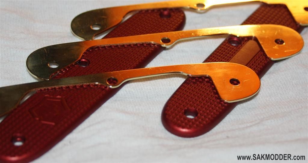

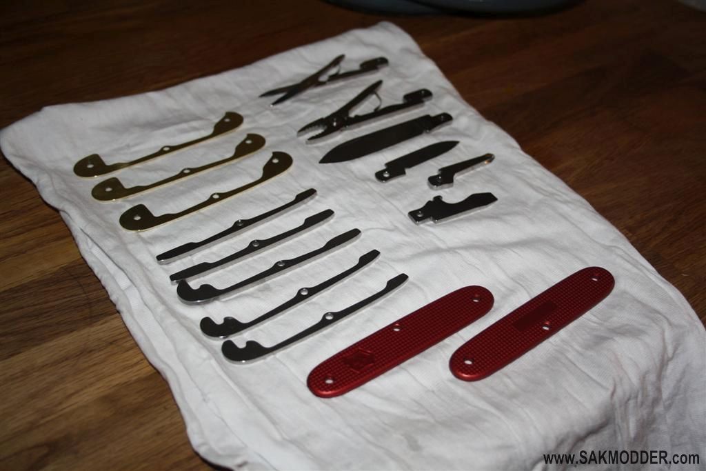

Tonight I made some good progress on another new mod for me.  Similar to Bushidos Alox deluxe tinker, but with a small blade nested with the large.
I have all the hardware parts prepped, and I hand made 3 brass liners for this beauty.
This is the first time I put Red HA scales with polished brass liners, and when I put them together I thought, wow this is pretty.  I really like the look of it and I think brass is going to find its way more often into the liner rotation.
I just have to do the pin splice trick and I can assembly this tomorrow.  There is alot of backspring there so I hope it won't be too tough to get the pins popped in place.
Cheers

Offline Capbyrd
    • Posts: 34
Reply #213 on: July 14, 2012, 07:42:48 AM
Man the brass liners look :drool: :drool: :drool: :salute: :salute: :salute:

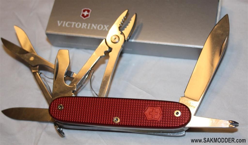

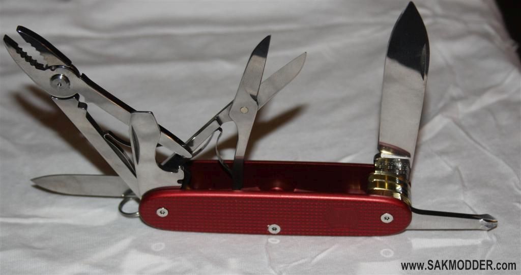

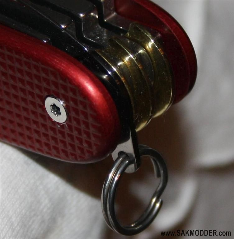

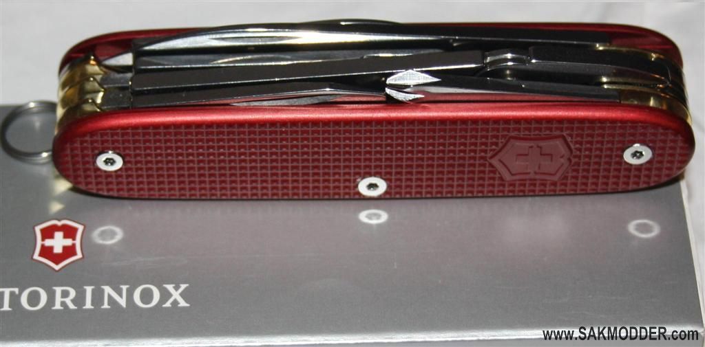

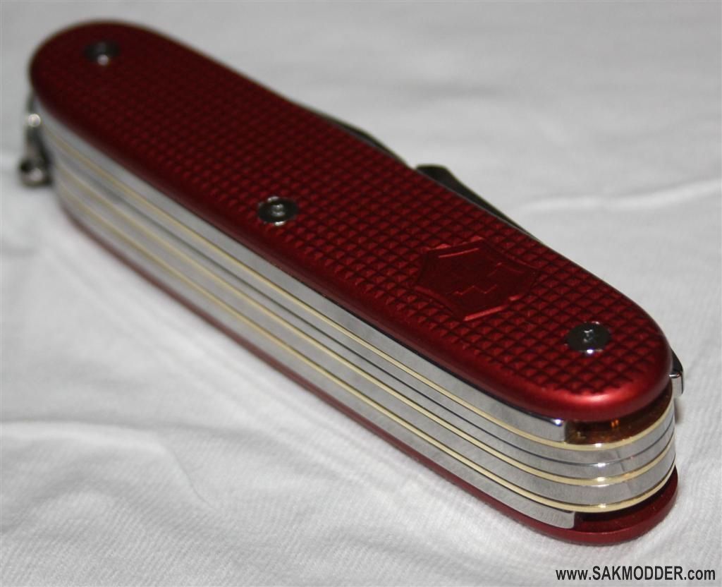

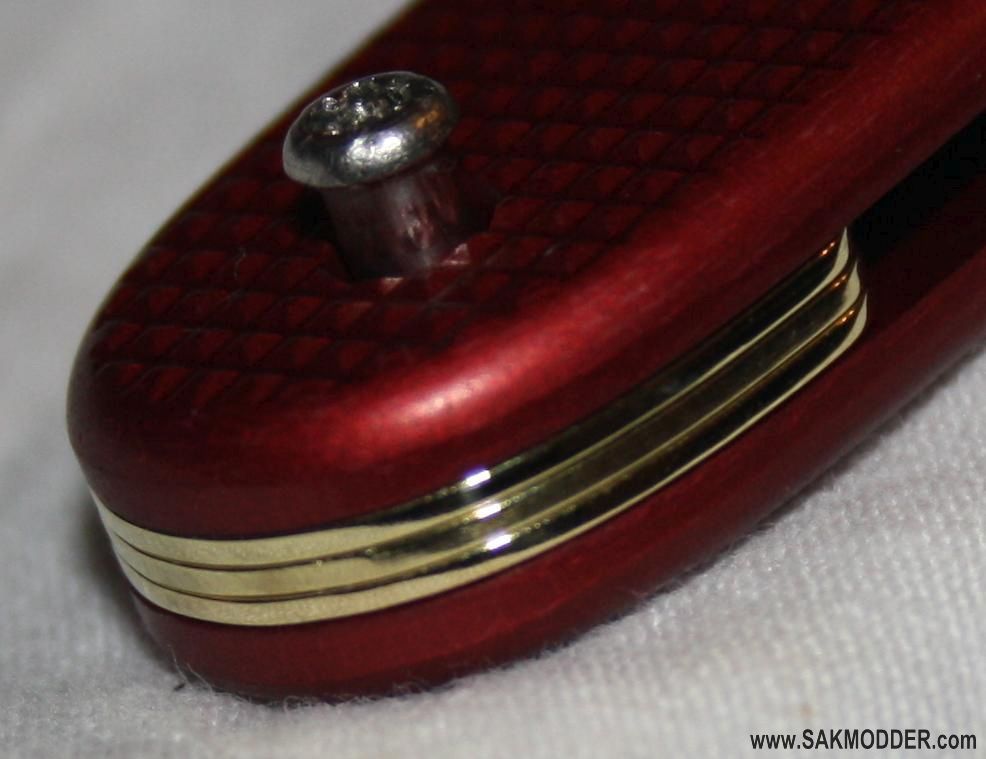

Reply #217 on: July 16, 2012, 04:31:39 AM
I got this red scaled beauty together tonight.  I wont lie and say it was easy.. it took alot of fiddling and custom washer making and test fitting.  I'm darn happy with the outcome though!  :D
I love the brass!  When I get some spare time I'm going to make up a bunch more brass liners.
This has a Titanium keyring spacer, a regular one wouldn't be strong enough to hold the weight of this beefy SAK.
The tool loadout I tried in a bunch of different orientations, but in the end I was happiest with the way Vic does it with pliers and scissors opening the same way, opposite the main knife.  The other ways didn't look as esthetically balanced IMO.  All the tools are easily accessible and everything has good snap.
Cheers!

Reply #218 on: July 16, 2012, 04:47:59 AM
That one is the bes one yet. Great tool set.. :tu:

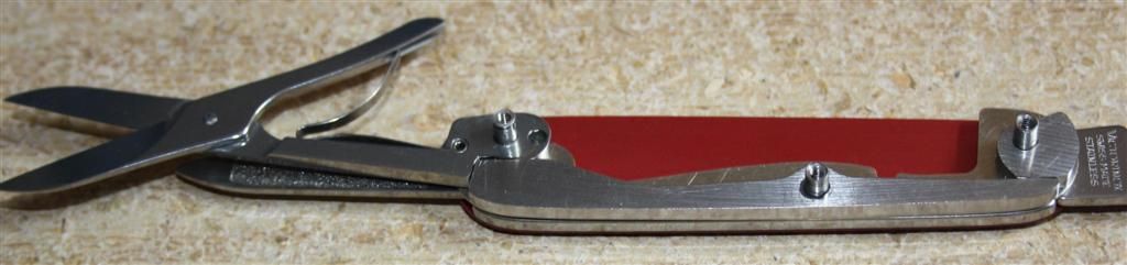

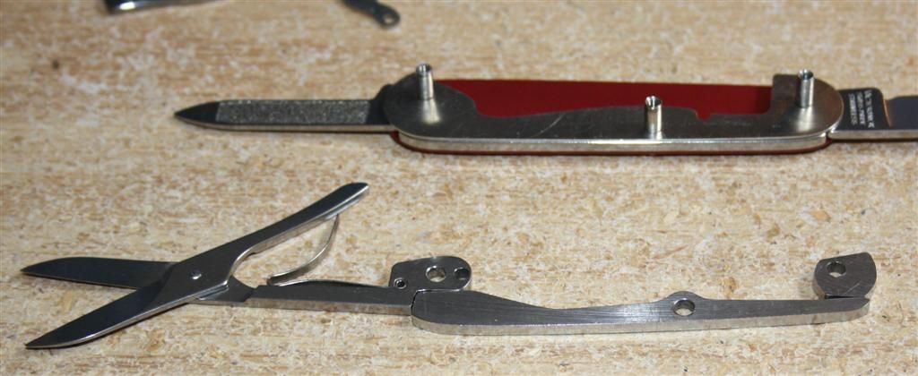

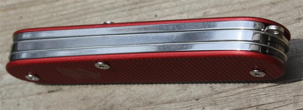

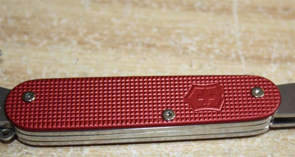

I've been working on the cadet with scissors mod for awhile now, so I finally put together the prototype.
It works great and the scissors have a hefty snap.  These are scissors from a 91mm SAK that I modified to fit on the 84 mm frame, since finding 84mm scissors now is pretty rare.
I sanded down some standard button head screws to make them as flat as possible, but I think I will try to countersink some small ones next.  I like to try to make them as flush as I possibly can.
Since the 84mm scales are thinner than 93mm scales I gave the pivot the maximum amount of scale to pivot on for strength, but I think I can split the different and have the pivot extend 1/32 inch into the scale and use the rest of the scale to sink the screw into.

Reply #224 on: July 18, 2012, 08:46:20 PM
That's some excellent modding mate. 8)

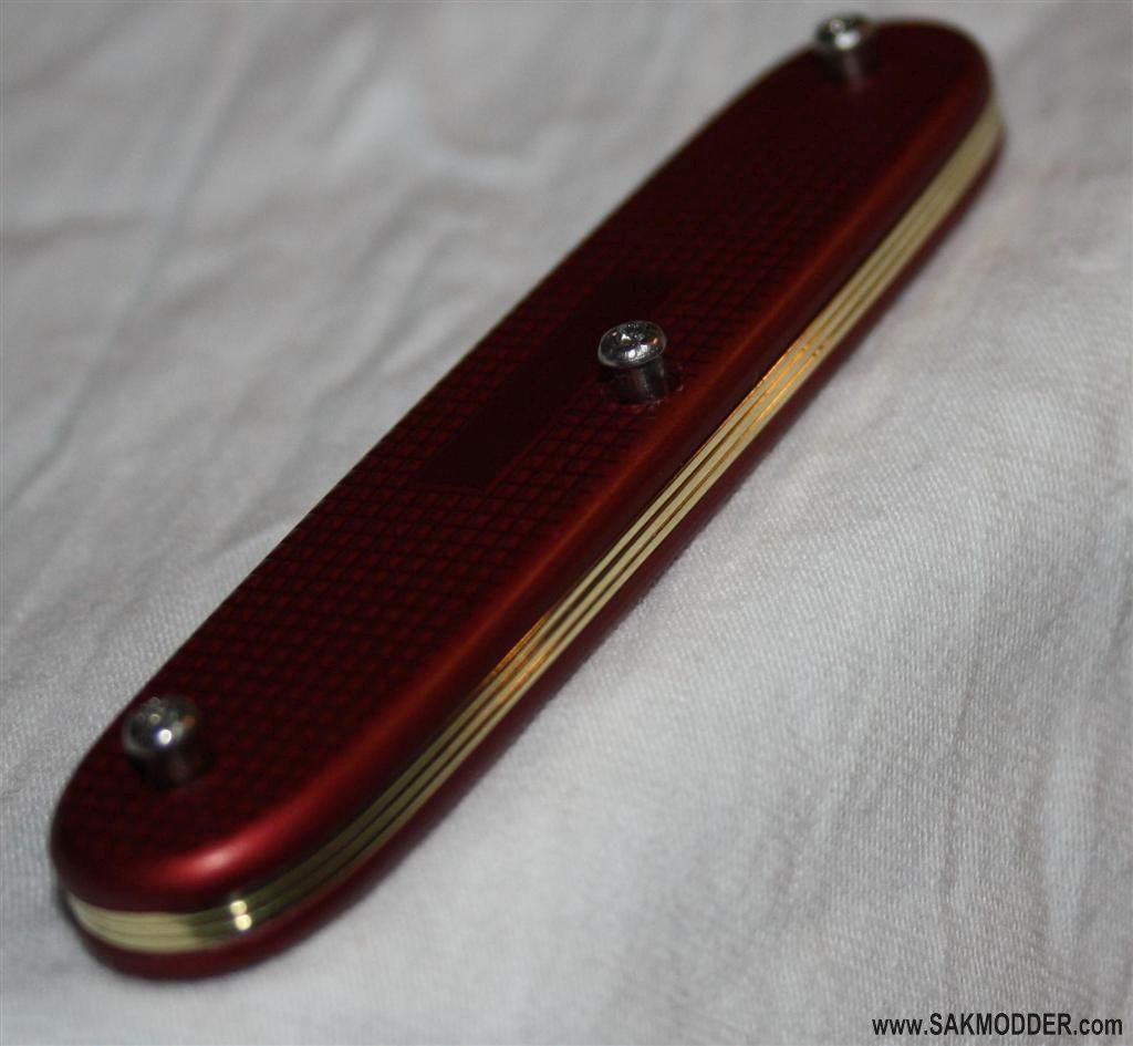

ca Offline Syph007
    • Posts: 9,842
  • SAK Surgeon
Reply #234 on: July 19, 2012, 05:04:44 AM

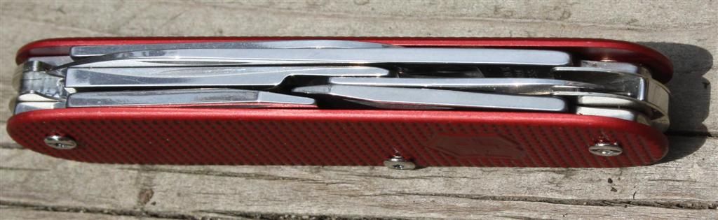

Quick update to my super cadet (what would the proper name be anyhow, cadet plus?).  I didnt like the first type of screws I used so I ground down some countersink ones and got those to fit nice.  Looks better I think  :D
