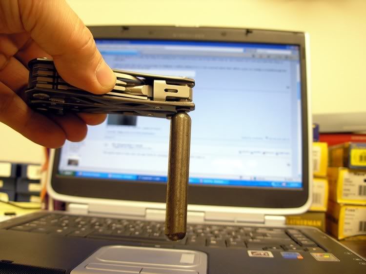

Notice anything missing. By the way the chicago rivits are alluminum. This thing really does not work for me. I honestly gave it a try, but look what happened yesterday while atempting to cut a fan belt. Another rivet just popped right off.The cutting blade and all tools on that side are just held in now by friction.
I did not abuse it, or make this thing do anything that I would not have any of my other tools do. but Comeon can I now jsut label this thing as Junk guys.
I will not return this tool a second time to Wallmart. I will be sinking it in a 2 ton concrete block that will be a part of a bridge in Southborough Ma. May god have mercy on its soul.

Yup, First time was the joint at the plier end and the second is the knife blade pivot.
Funny thing is both came from Wallmart. So I dont know if that was a factor in it. All I know is no one can say I dont have a unrealistic predudice on this tool. The proof is in the pudding, and I gave it 3 honest attempts, where 2 came through with broken tools.
So I guess I will go back to lothing this tool :ahhh

Tom, you may have hit upon the answer there. While I do not doubt that both of Hawkchucker's Suspensions had aluminum pivot screws, mine are definitely not. I can stick a cow magnet to any one of them, meaning they are some sort of carbon steel, probably 400-series stainless.
This matches my results from checking out two different Suspensions, my own and one belonging to a friend.
Both Suspensions came from the local Lowes, both are all stainless steel including the pivots, and both have absolutely no aluminum in them that I can find.
I checked all parts using first a magnet, and second by scratching each part with a steel blade and then with a carbide drill.  Hard steel will scratch aluminum fairly easily, but not other steel.  A carbide drill will scratch steel similar to steel scratching aluminum.
However, maybe Gerber also made a lower-quality variation? Foolish of them to put their good name on a bad product if this is true.
I agree 100% with this observation!  I don't know why Gerber would do this, but I'm guessing it isn't intentional.  I'd bet it's due to lack of oversight of Quality at the Chinese factory that produced it.
Pivots would be about the worst possible place for the manufacturer to cheap out and use aluminum, due to the stress the pivots routinely experience.
Aluminum handles or aluminum scales are perhaps acceptable on a multi, although I don't really care for them.  But, aluminum pivot pins are totally unacceptable.
After several months of using my Suspension around the house and out in the yard, I still like it.
It's accomplished a fair amount of electrical repairs inside the house - replacing outlets, switches and the like.  Outdoors it's been used to cut back stray branches, rewire an electric lawnmower, change out the chain on a chainsaw, and too many other tasks to list.  It accomplished all of those tasks without ever feeling like it was about to break.
While not a heavy duty tool, I'd judge the Suspension to be somewhat more robust than my old Leatherman PST.  However, since it weighs nearly twice as much as the Leatherman, it should be more robust!
It's nowhere near as robust as my SOG Powerlock, but it cost less than half as much.  For ergonomics and ease of tool access it beats the SOG handsdown.
For less than 30 bucks and the ability to exchange it at Lowes if it breaks, I still think it ain't a bad deal.
