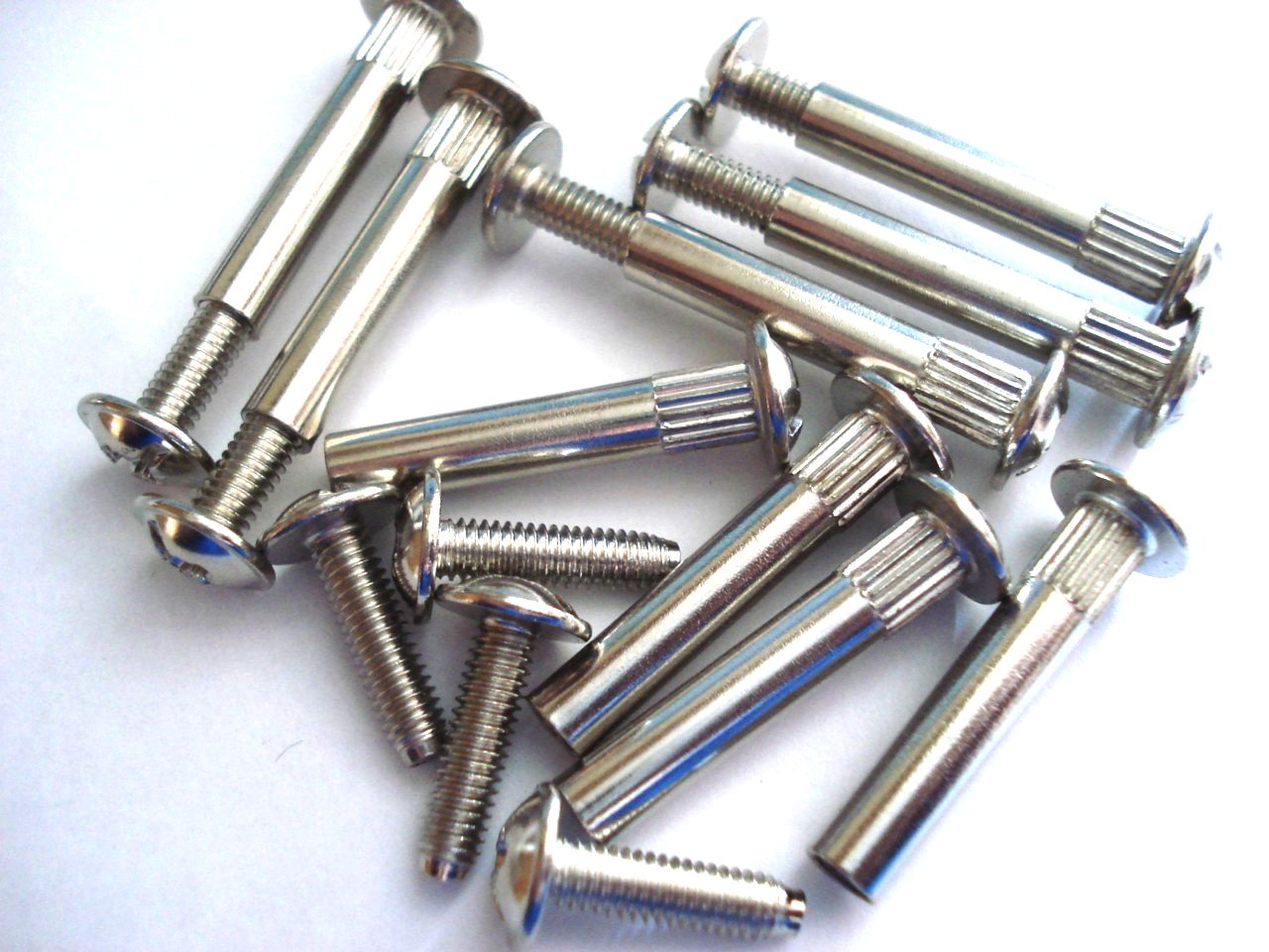

The next step is the handles. I went for the simplicity of full tang. I used the wood from a new small axe handle which I cut in two halves lengthwise. This spared me the gamble of using unsuitable or wet or soft wood.
For the 1st knife, since I could not use pins as I could not drill the metal I cleaned it thoroughly and used strong epoxy glue. I applied pressure to the handled and let it set, clamped for half a day.
For the 2nd knife, since I was able to soften it properly and drill holes I intended to use epoxy and two pins. I also wanted to leave a large lanyard hole… . Ideally I would have used corby style rivets or chain bolts or something similar but I was not able to find any… maybe next time.
I went for a traditional, butcher style blade. I did not remove all the file teeth from the sides as it would have made the blade too thin, and, they looked nice.
The only pins I could find were “spring” pins that you hammer through the material.
I really should have hammered them first halfway through the tang and then put the wooden handles on, but I put the epoxy on and tried to hammer them through the wood and then the metal..
So, since from what I realised I missed a hole by a bit, a part of the metal handle snapped because of the hammering . Thus , since everything was covered in epoxy I just had to glue the handles, with no pins, and lose about 4cm of the total length… and have nasty holes in the handles.
I filled the holes with putty later.

Get some proper rivets.

Continuing my search for a screw system, suitable for securing handles, I found and bought these connecting screws, used in cabinet making. Not pretty but you end up with the same look on both sides and they are pretty solid.
Here is an example of the type of product from Amazon for your reference.
http://www.amazon.co.uk/KITCHEN-CONNECTOR-BOLTS-SCREWS-HOLE/dp/B007V2GZ0E/ref=sr_1_2?s=diy&ie=UTF8&qid=1415206742&sr=1-2&keywords=connecting+screw

Saw screws work well and tend to be a little shorter, so less to cut down. Plus they have that classic hand tool feel.
Here's the website to my local knife makers shop. I don't know if they will ship overseas but you can get idea for some types of hardware to look for.

Not even amazon.uk will post these to me. :D
The shipping cost can also be stupidly high.
I went through all the DIY/hardware stores and all I could find were these, at one store. Even cabinet makers use the plastic headed ones now.
I will check the bike shops too as they seem to use some similar style screws for the chains.
All in all I am happy with my find.

Bike chains have pins holding them together, fairly small ones at that so I don't think they'll be able to help you out. Unless you guys have vastly different bikes?

I am thinking of these chain ring bolts.
I have seen them mentioned for knife making in some threads, depending on their size:
http://www.chainreactioncycles.com/cy/en/chainring-bolts
I assume they will be available.

Ohhhhhhh I gotcha, good idea. Sorry I misunderstood you, didn't want you to waste the trip
