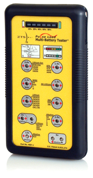

Is there a gadget or how do you measure the remaining power in CR123 batteries?

In primary lithium cells it's best to put them under load then test the voltage. I have a multimeter that'll put around 100ma on it while testing voltage but there are dedicated testers that'll put 900ma on it while testing for voltage.

I use a
ZTS tester.
Specifically the Mini model. It seems to work great and gives readings from 0-100% in 20% increments. I waited much to long to buy one, had I known how useful it was I would have purchased one before ever buying any lights.

ZTS is the way to go. It applies the proper load depending on what type of battery you're testing.

Thanks Spoon and Terry! I really really need this multi battery tester!
Edi, How do we place an order?
