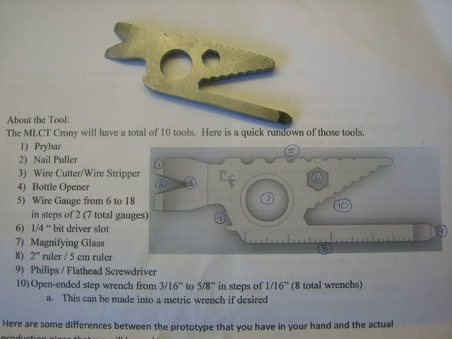

Just got the Crony from Andrew along with 3 printouts describing the features, but the mailing list was missing. Just wanted to know who's next on the list.

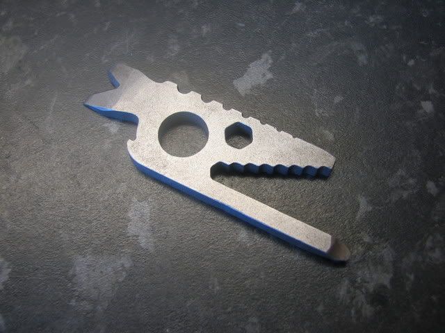

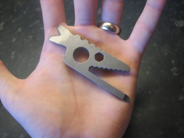

If the Terminator was a rabbit, this'd be what its skull looked like.  I mention this because I'm having issues remembering the thing's name from one moment to the next even when it was sat in front of me. MLCT Crony is not tripping off my tongue :)  I've nicknamed it ROB (Rise Of the Bunnies).  One syllable and three letters I can remember :D
Getting people to recognise and remember the tool is important if you want to market it and that brings me straight to that big hole in the middle.  On a practical front I don't believe a magnifier has any business being integrated into this tool.  I like and use the magnifiers on my SAKs frequently but I can't see me going for this tool for that requirement.  This is a hard work tool and a fragile lens is not a good idea, its going to get hit, dropped and walloped.  From a marketing perspective though its a superb idea.  As Ben mentioned, people will then recall the tool as being "the one with a magnifier".  It'll look good and make it unique among its contemporaries (hope I spelt that right).
The ability to add a split ring would be good.  I know you could put a lanyard through the hex hole but how about a little hole drilled through ROB's nose?
Back to useage...
 - The screwdriver whilst a little cumbersome will do the job, I realise almost any tool design on a small flat bit of steel is going to be a compromise so I have no criticism in this area.  Don't shorten it though!
 - I popped a security torx bit into the appropriate hex shaped hole and took it for a whirl on the back of my recently defunct set-top box.  It was awkward but did the job.  Its a hole, you lose nothing by including it and who knows, maybe one day you'll have nothing with you except a ROB and a few bits.  Should you need the space for another feature though then give it the boot.
 - Whilst you're not going to take down a garden shed with this little tool, the prybar aspect works well for a tool of this length.  My only bit of constructive criticism would be to make sure the outside corners of the prying end are smoothed off on the production model as they do jab into your hand whilst using the screwdriver.  I'd check the width as well, to ensure that each prong will fit under common staple sizes.
- The bottle opener works OK but I would just increase the distance between the hook and the prying part a fraction.
- Lastly the wrench.  On the few bolts I had that fitted it worked great.  I'm assuming this is a metric versus imperial issue but almost all of the bolts I proffered it wouldn't fit :(
So would I buy one?  Its great to see innovation and I wish you great success but the wrench is a deal killer for me I'm afraid.

Actually, what I think I'll go about doing is designing a whole new tool.  For people who use MOSTLY english or standard, but want both, then you can get the English/Standard Crony plus this newer tool with a metric wrench, ruler, and some DIFFERENT features.  This way, you wouldn't be carrying around redundant tools, but still get the added bonus of the metric wrench and ruler.  I'll do the same thing but reversed for our folks over the pond or anyone who would require Metric units first and foremost.  So the offerings will probably be as follows :
MLCT Crony - Standard Wrench, 2" Ruler, and all the other features
MLCT Crony - Metric Wrench, 5 cm Ruler, and all the other features
MLCT "InsertNewToolNameHere" - Standard Wrench, 2" ruler, and different features than the Crony
MLCT "InsertNewToolNameHere" - Metric wrench, 5 cm Ruler, and different features than the Crony
Of course, you are all welcome to just buy a Crony in Standard sizes and Metric sizes, but that would seem a bit redundant to me.  This new tool hasnt even begun the design phase yet, in fact I just got the idea for it as I wrote this post, so in the next couple weeks I'll probably start a new thread with the ideas for that new tool and look for your feedback there (as to what you would like to see in that tool that the Crony doesnt have)

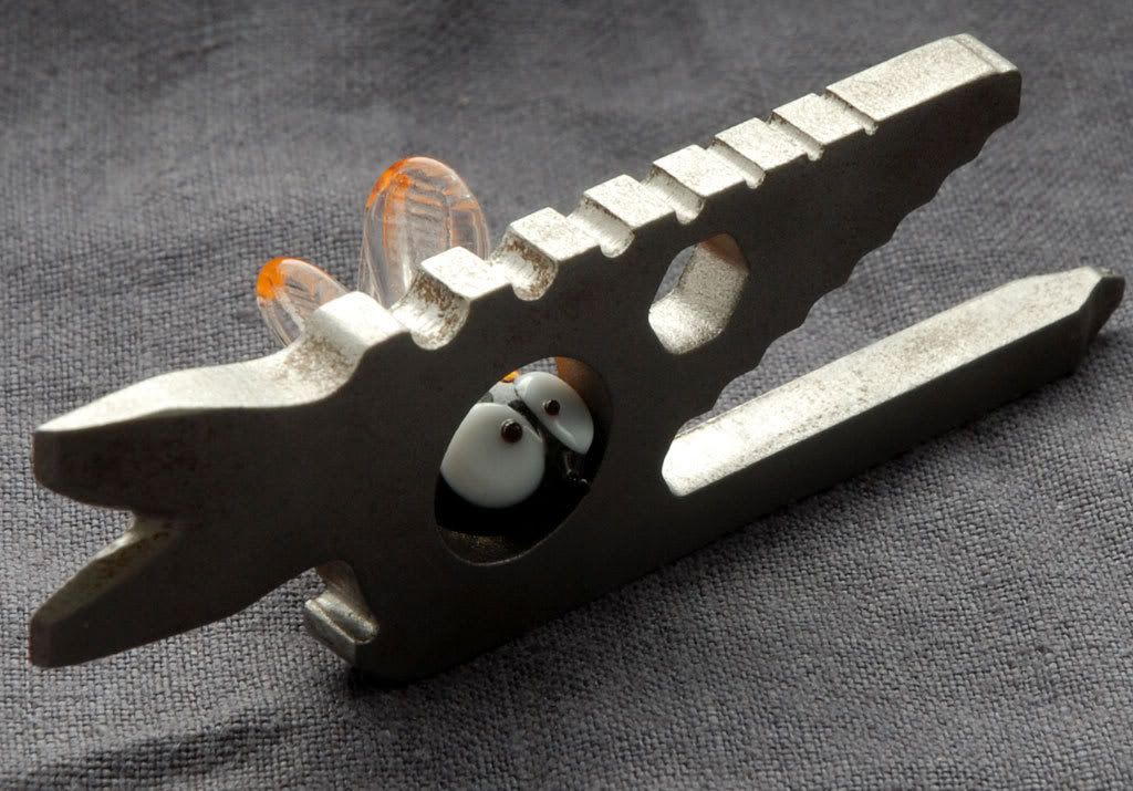

First impression picking it up was that the tool is thick and feels very solid. It sits well in the hand and none of the multiple sharp corners gave me any major problems when handling the tool.
Features: The philips/flat head combo (used to using one on vic sak can openers)  performed well on screws, the metal did show a few signs of stress (assuming the prototype is made out of softer steel, and the production model will be stronger) but it did do it's job. The wrench is a nice feature and did turn a few nuts. The hex driver didn't get any use by me, nether did the wire gauges. The bottle opener worked fine, and the pry bar was able to lift a few things I got to try it on.
Now to the giant empty hole smack in the middle screams magnifier :D it will make the tool unique and the tool being on the thicker side will allow the lens to sit deep enough offering it some protection. I'd like to see a ruler on it, with both metric and imperial measurements on the same tool. A "sacrifice" for a universal type of wrench would ease the logistic problem, and "one tool fits most" in something this size will not raise any complaints. A separate hole for a key ring is a must. Some type of a retained for the hex bits would make it more useful, and if the pry bar be sized for the common staple will give it an additional usage (as suggested earlier).
I do like the tool and would like one when they start coming of an assembly line  :D hope you can keep the price on the affordable side I still have other tools to buy  :cheers:.
Thank you again for the opportunity to test and review your tool, good luck and all the best V.
