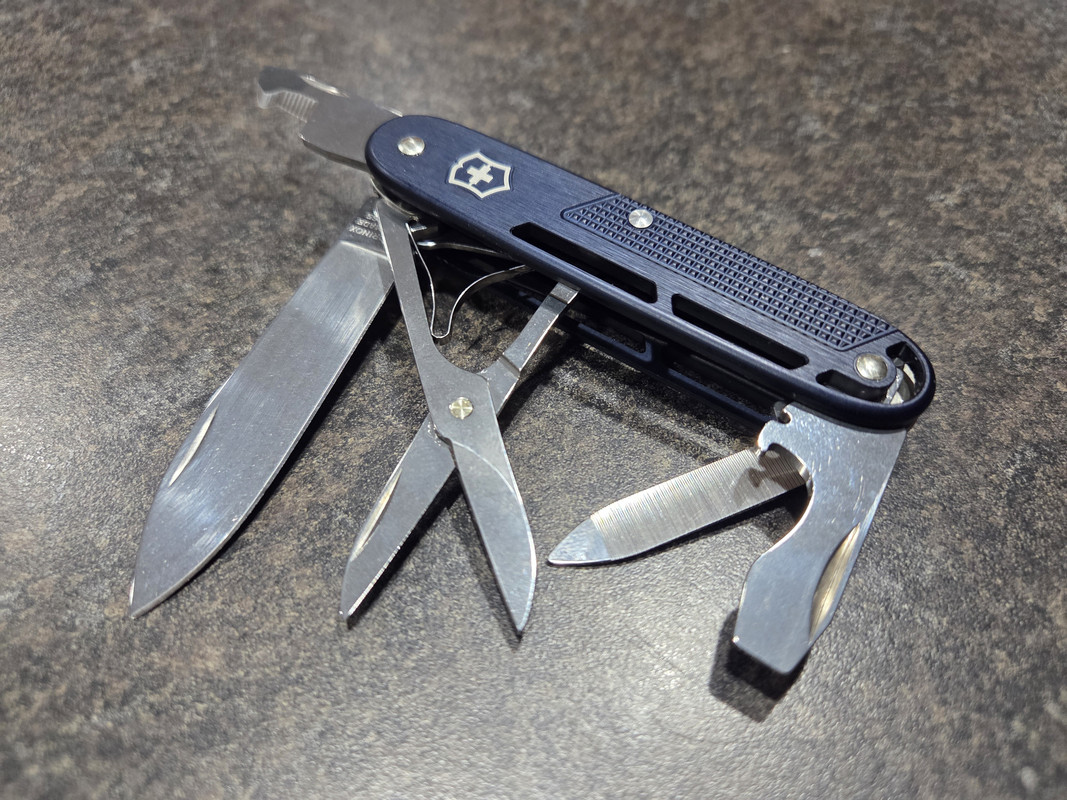

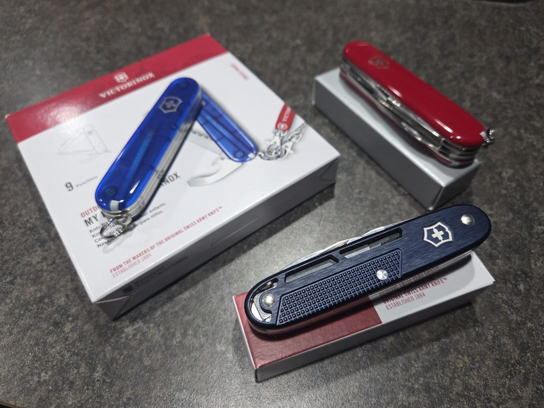

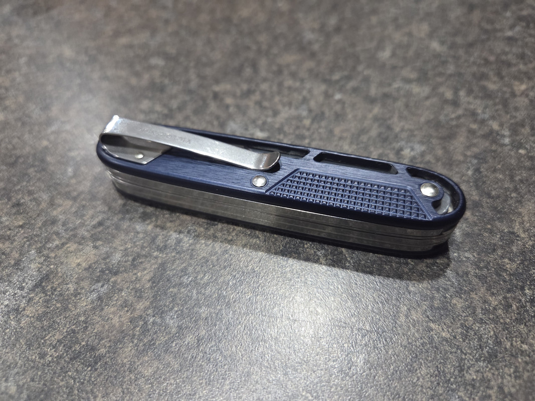

Here they are!  I'm liking the Synergy X, two things though, 1.  The pocket clip is quite weak, would have liked it to be a bit stronger and 2. Not sure about the cut outs in the scales around the pivots on the one end, I feel like that area is now weaker because of those cut outs.
No issues with the blade lock, I quite like it.  Love the dark blue of the scales and the rest is good to go!
Definitely going to be taking apart the Synergy X, maybe make a Synergy X Spydernox.  Just need to figure out how I'm going to get it back together with the pocket clip.
These are excellent points.
1. With daily wear and tear, the pocket clip will likely eventually need to be bent back for retention. This will be tricky since it is riveted in place.
2. I did not previously pay much attention to the scale cut-outs at the bottle opener/ flat head pivot. You are right Lazar, these cut-outs weakened the pivot area, for a tool that needs the strength to withstand twisting and prying forces.  :facepalm:
Someone also mentioned how the cut-outs are likely to trap pocket lint. Perhaps these are intended to be "lint repositories" and count as an additional functional feature? In theory it could save your bacon one stormy night out in the woods when you need tinder to start a fire...  :D  :pok:

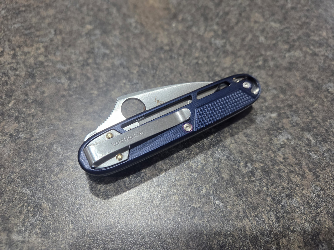

I did a little something to my Synergy X

That's a SWEET mod  :hatsoff: :like:
    • Posts: 6,933
Re: Victorinox Synergy X
Reply #112 on: October 25, 2025, 09:29:45 PM
 :iagree:   :like:
Does that make it a Dragon X? SynerFly X?  A DSX?  :cheers:

Wow, that was fast! Looks nice.
I’m really curious how you put the torx pivot in with the clip? I’m assuming you had to remove and re-rivet the clip with one of the torx screws in place, but then how do you tighten it?  :think:
That's correct, had to remove the pocket clip, drill the holes to 2.5mm since Victorinox had the pin step down to 1.6mm, then rivet it back in place with the barrel and screw in place.  Used red locktite on the screw.  Upon assembly everything went together fine and tightened just fine.

...drill the holes to 2.5mm since Victorinox had the pin step down to 1.6mm...
Are the standard 93mm alox pivots not 3mm in diameter?
Do I understand you correctly that they are now 1.6mm on this model? Similar to the 58mm pivots? Wow...
Edit: Pivots are still 3mm. See next post.
I was talking about the pocket clip holes and the holes in the scales for the pocket clip.
The pivot holes are still 3mm.
