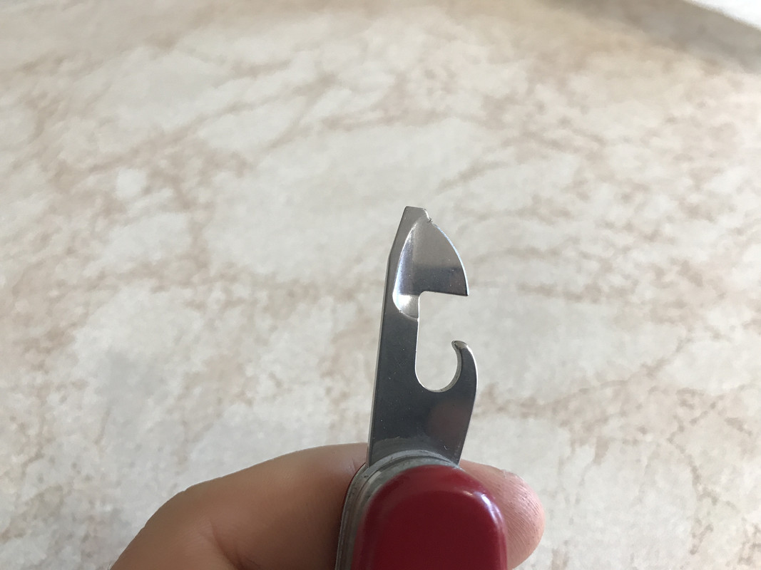

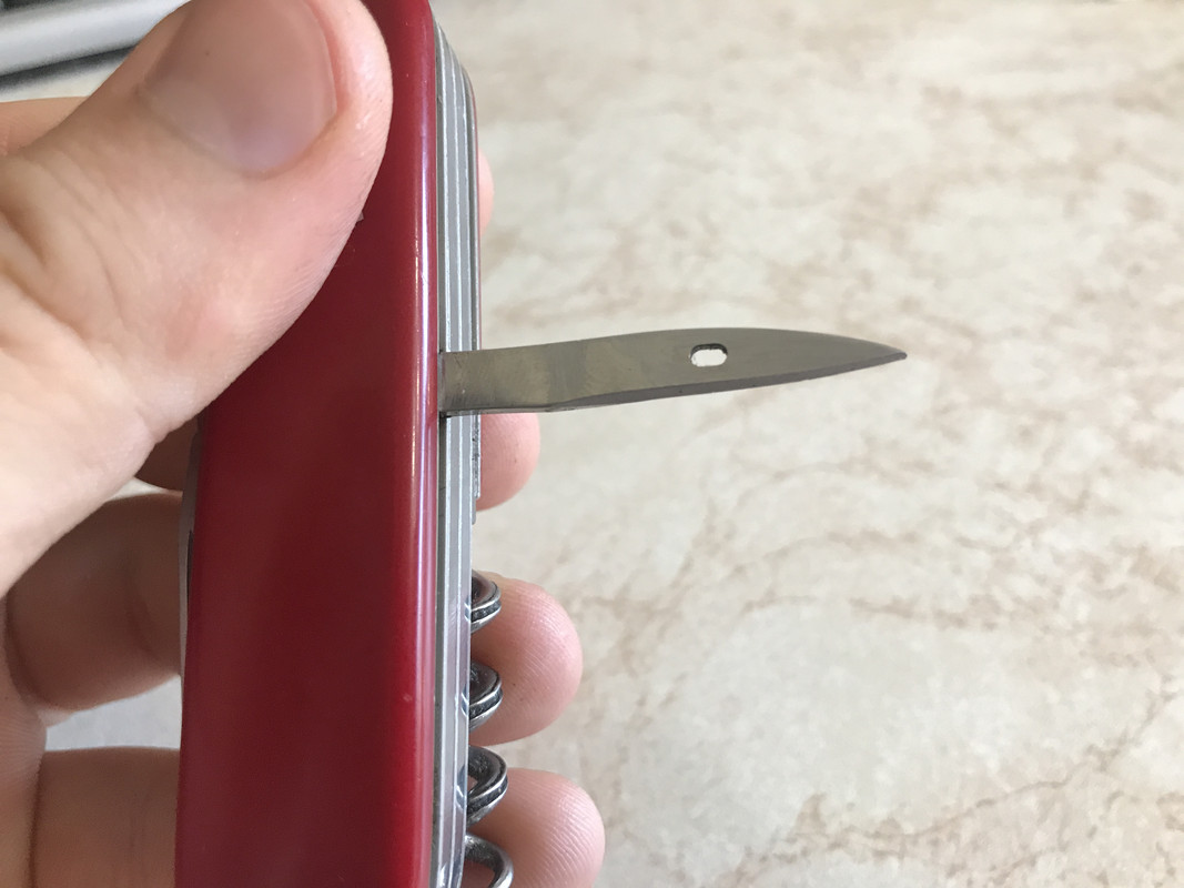

While I was working on it, I took the opportunity to use my Dremel to grind the tip of the nail file into an awl, following McStitchy's idea in https://forum.multitool.org/index.php/topic,47771.msg2249311.html#msg2249311
