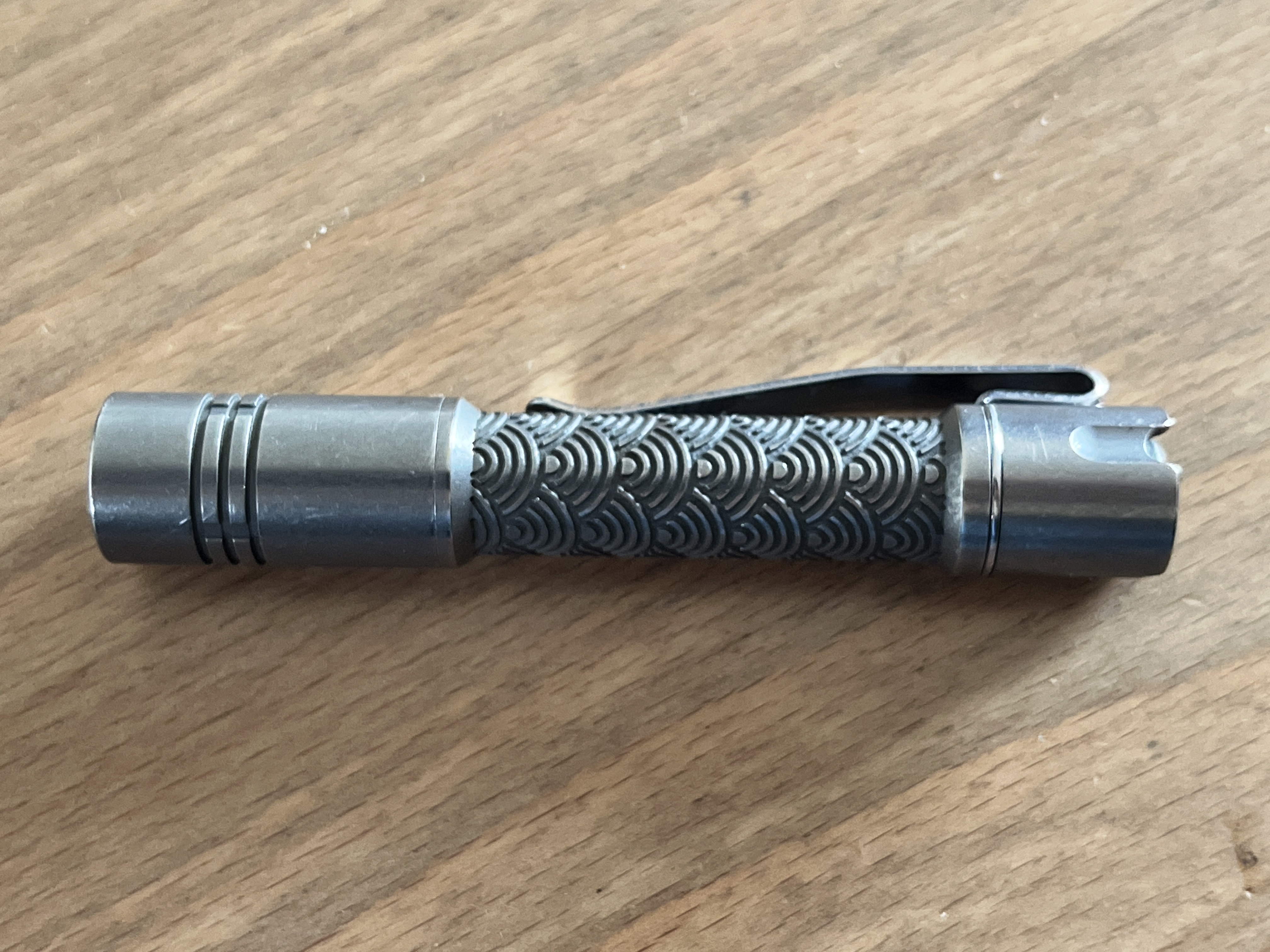

My daily carry flashlight of three years:
With this, I found a keeper.
By the time I got to the RMP I'd been through several different EDC lights. None of them had completely satisfied me, so I decided to work out exactly what I wanted from a light that would be on my person all the time. Yeah, I do clip my flashlight to my pyjamas or T-shirt when I go to bed at night.
My list:
  • It had to be cylindrical, AAA-size. This works best for my jeans pocket and feels best in my hand. Round rather than flat lights are my preference for handling, AA lights are too big and heavy for something I'll have on me all the time (and will hold in my mouth when my hands are busy).
  • It had to be able to run any kind of AAA-size battery - 10440, NiMH, disposable. Lights with a non-removable battery are good for some things, but I wanted the option to carry a spare or buy another battery and not be stuck until I could charge the light.
  • It had to be operable with one hand, with a very simple interface. I wanted to be able to use it without thinking, including when mostly asleep, or after a few drinks. To me this meant a tail-click light, one without bells or whistles that could be confusing.
  • It had to have several levels of brightness, including one low enough not to wake people up in a dark room, and one high enough to cover my realistic needs - walking or doing tasks outside the house at night. Massive lumens not needed, but >100.
  • It had to have a functional deep carry clip.
  • The light produced had to have warm tone with good colour rendering. I don't like bleached out light that's harsh on the eyes, and I can make sense of what I'm seeing quicker when colours look natural.
  • I wanted something that would look good and feel good in the hand. Something you'll use multiple times every day ought to be a pleasure to use, if it can be.
  • I wanted something that would last, preferably with replaceable parts. My previous EDC light had a clicky button that failed after 6 months, and since the particular version of that model was no longer produced I couldn't get a replacement tail cap that would let me carry on using it, only one in a different material and colour. The button mechanism was sealed into the tail cap, so I couldn't see any way of swapping that out. The light was thrown away.
With all these requirements there wasn’t a long list of candidates. The RPM fit the bill and I got it in stonewashed titanium with seigaiha-pattern machining and a Nichia 519a.  At the time the tail-standing end cap was not standard and came as an add on part, which I got. Switching the cap was simple to do. It's standard on the newer RPMs.

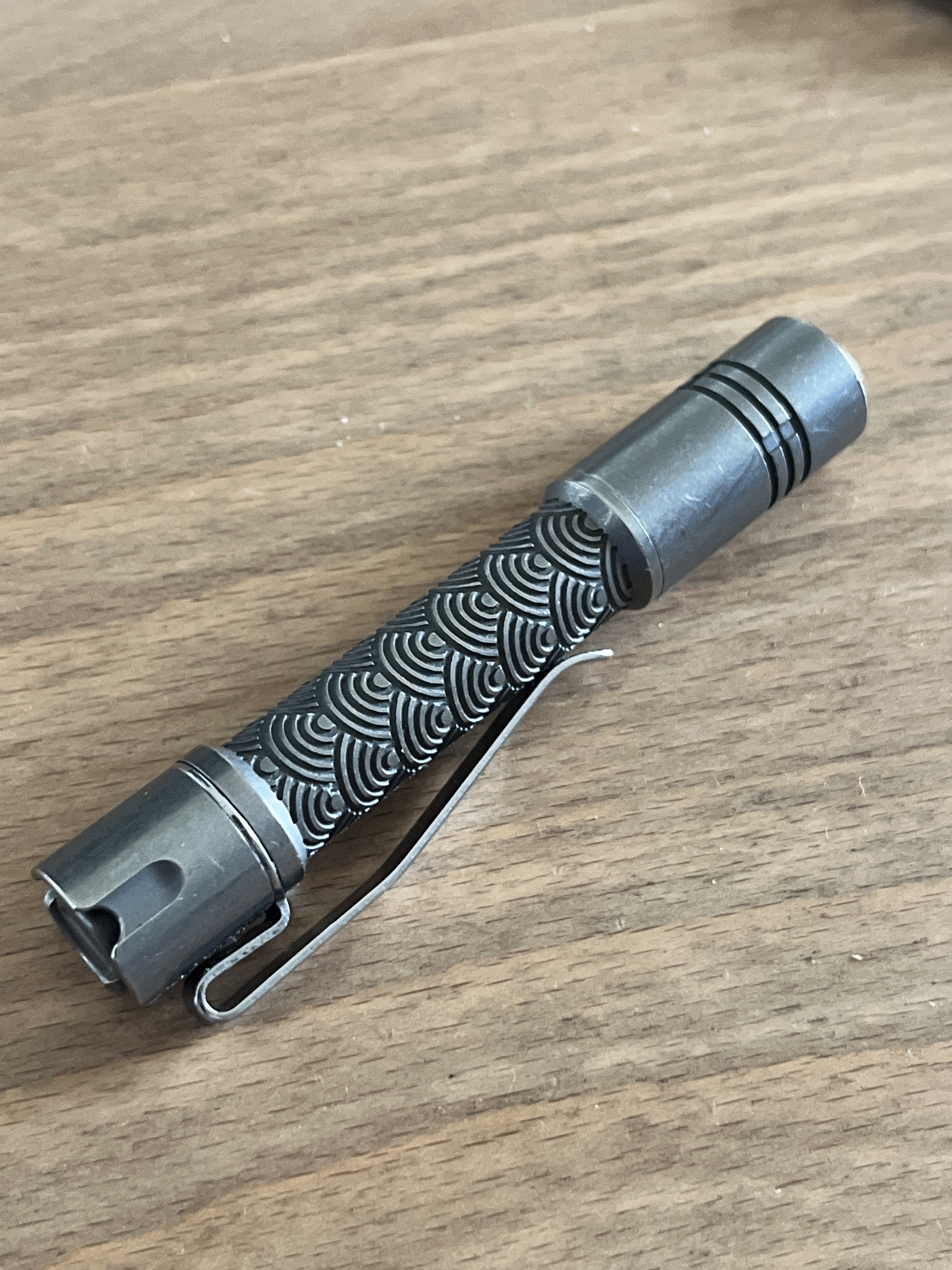

I immediately liked the light. It couldn't be simpler or easier to use, and the size, weight and texturing of it  mean there's a multitude of ways you can hold and manipulate it. The seigaiha patterning is really extremely grippy, making it hard to accidentally drop, even when held between two fingers like a cigarette:
It also feels just right in the hand, solid but not heavy. An aluminium AAA light can feel like you're clutching a seed pod; the RPM looks and feels like it's indestructible and built to last forever. It'll probably be dug up by an archaeologist 1,000 years after I'm dead. Light-wise, it does what I need it to, and on max output with a 10440 inside is powerful enough for anything I'm going to use it for. The light shed by the 519a is lovely.
I've carried the RPM almost every day since I got it, and have really enjoyed the way it's acquired character as the stonewashed finish has become semi-polished and minutely scratched with pocket time:

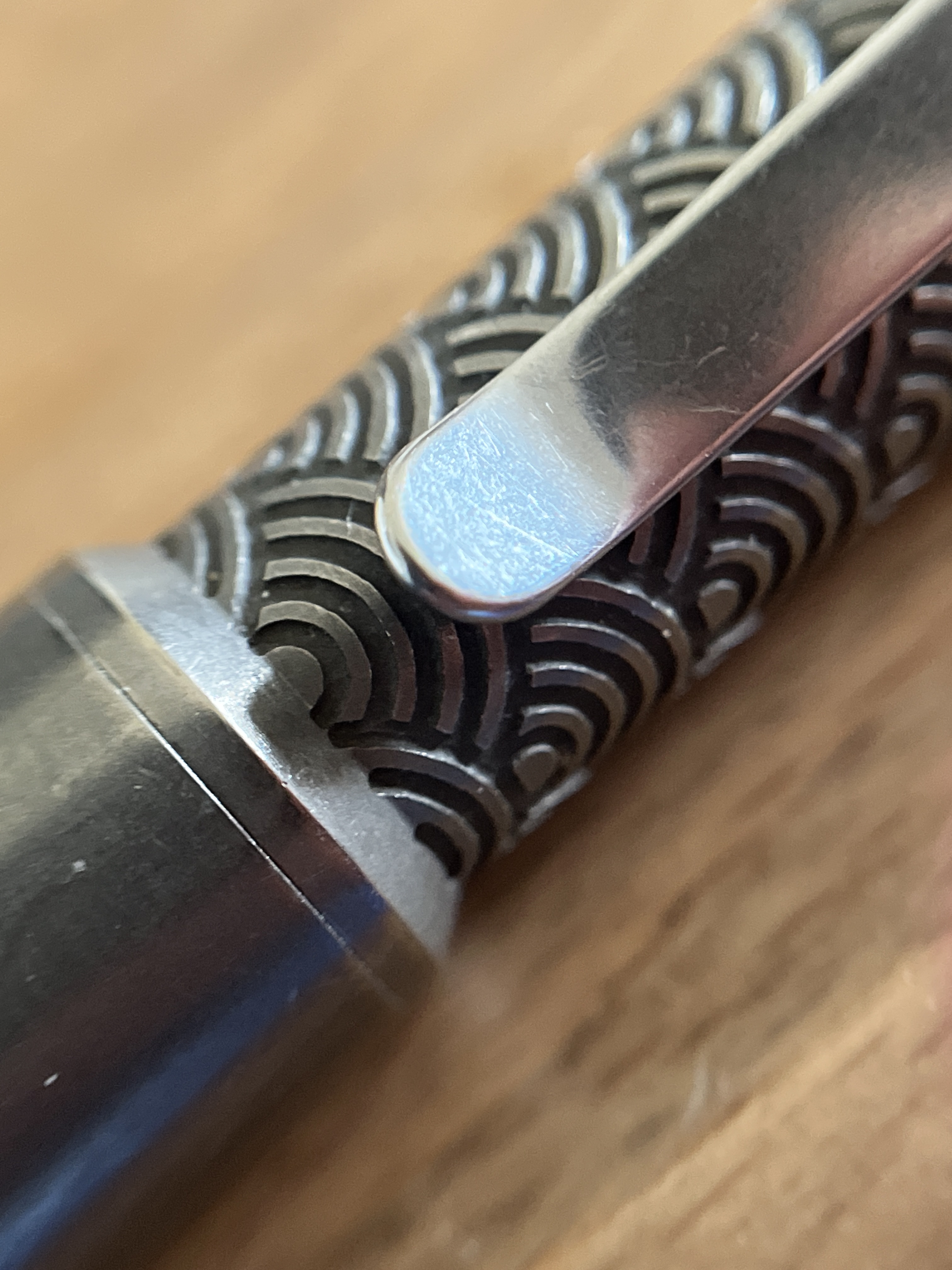

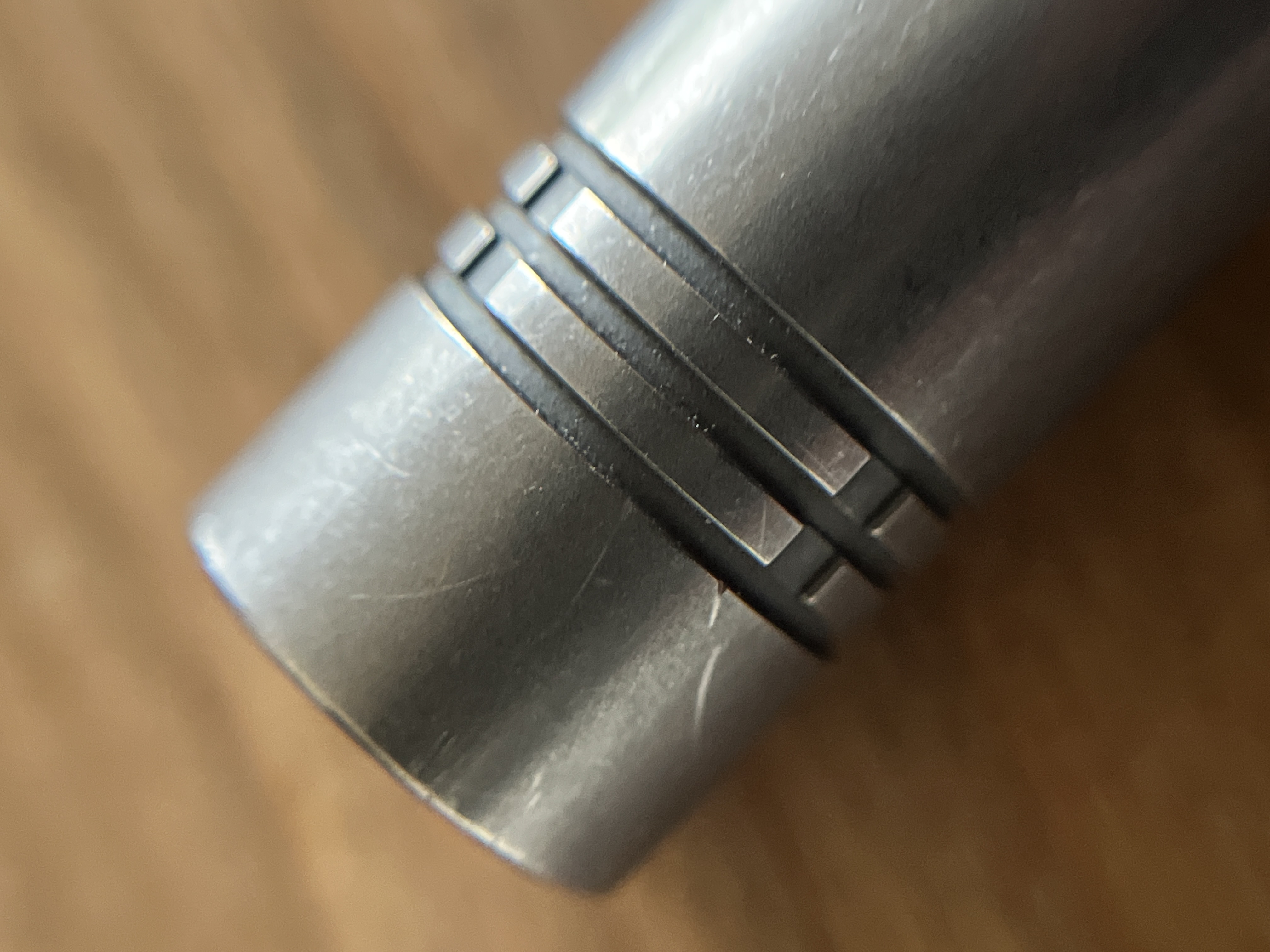

The seigaiha pattern now stands out with much more contrast than it originally did, as the exposed surfaces have become shiny, while the grooves between them retain the original dull grey finish:
You can see the difference between how it looks now and how it did when new by comparison with this almost new Reylight Rook, which has the same stonewashed finish:
Ultimately I just dig Rey's design. I don't know the extent to which he is influenced by Japanese aesthetics, the use of seigaiha pattern suggests he is, but to me this is the small flashlight a Samurai would have carried, if they had small flashlights in the Edo period. It's one piece of my daily gear that I don't feel like I will ever want to replace.

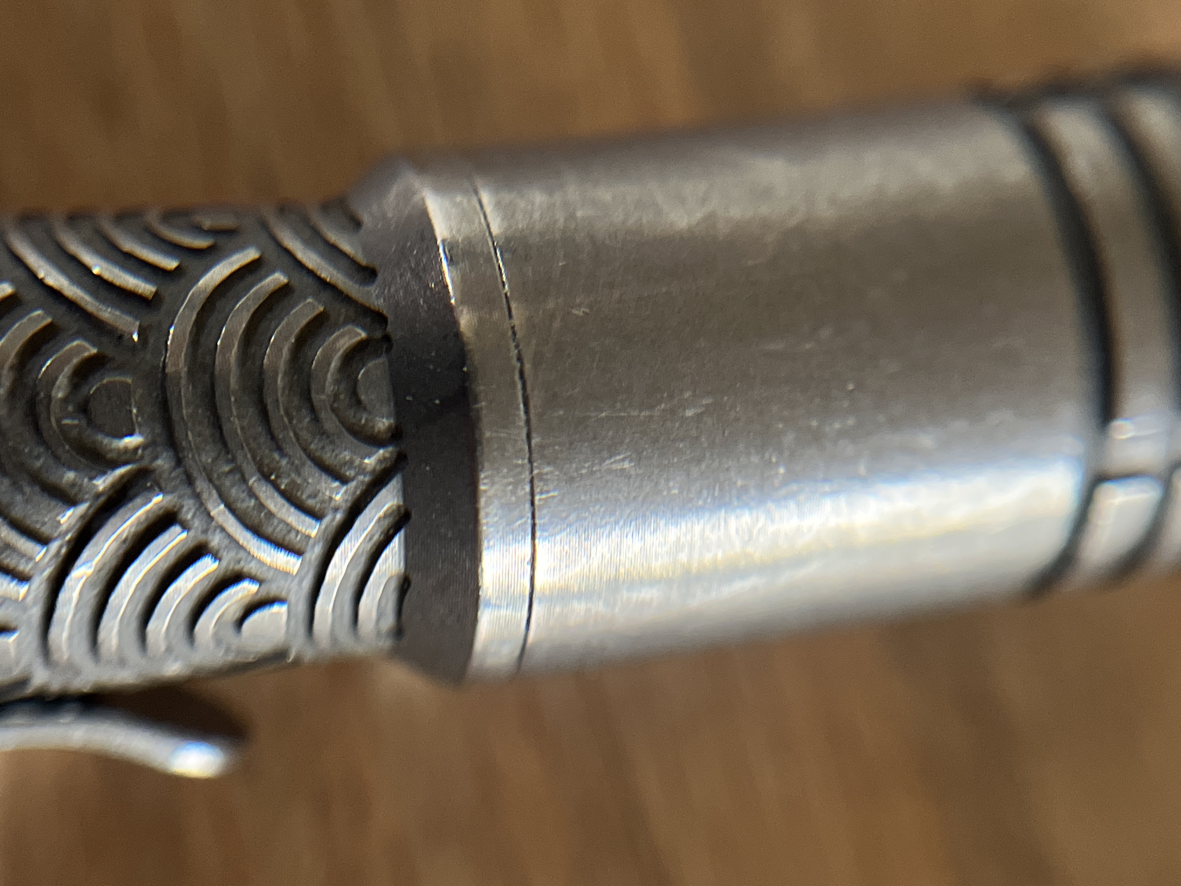

    Negatives / points for consideration:
    • Because it is small and light it is easy to mislay. Not really a flaw, as you want a light like this to be almost unnoticeable to carry, but if you have it in your pocket you may forget it is there. On one occasion, this resulted in my RPM taking a trip through the washing machine and tumble dryer, after which it was very clean but did not work properly. This is where buying from Reylight, as opposed to the Flashlight Megacorp, pays dividends, because if you have a problem you can always email Rey. I did so, and for $15 he sent me a replacement pill, including the correct pair of tweezers for screwing the pills in and out. It took 30 seconds to fix the light.

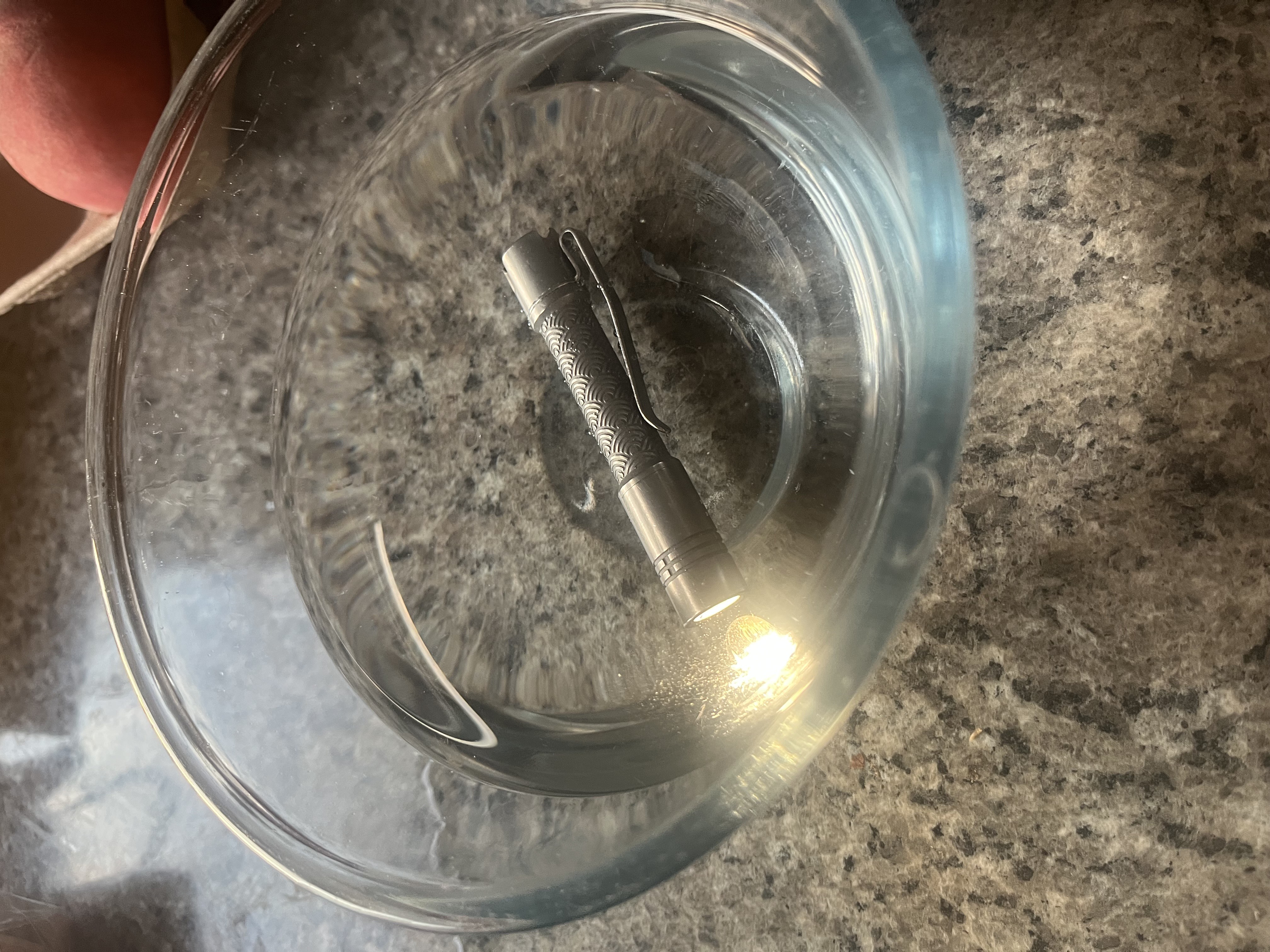

    • I don't know how waterproof it is (not enough for the washing machine). Reylight doesn't specify an IPX rating that I've ever seen. I've dropped the light in puddles, and it was fine. My non-scientific test says 'waterproof enough':
      but the negative is that liquid can penetrate the button end of the light. This doesn't affect it working, but gives it a squelchy action until it dries out. This has mostly happened, disgusting though it is to consider, when I have had to hold the light in my mouth for an extended period of time and have drooled into it. Fortunately it is easy enough to unscrew the button end and wash it out if needed.

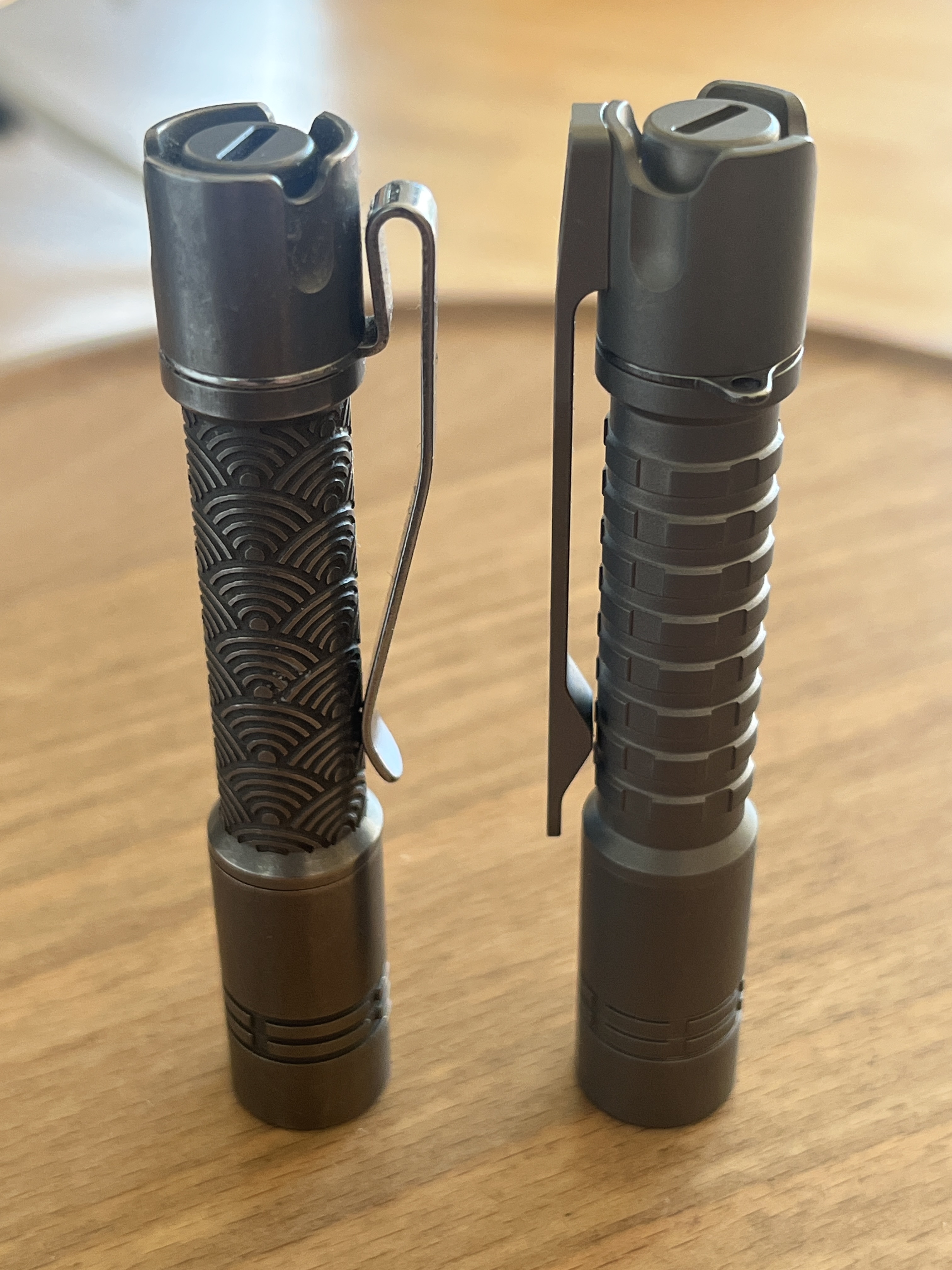

Here's the promised comparison between Mk.1 (2022) and Mk.3 (2025).
I felt it would be boring to buy the exact same light again, and in fact a seigaiha pattern Mk.3 is not yet released, so this time I opted for the "frag" pattern in beadblasted, rather than stonewashed, titanium. I believe the frag design is the original one for this light - the Pineapple name deriving from the fact that it supposedly resembles a grenade.

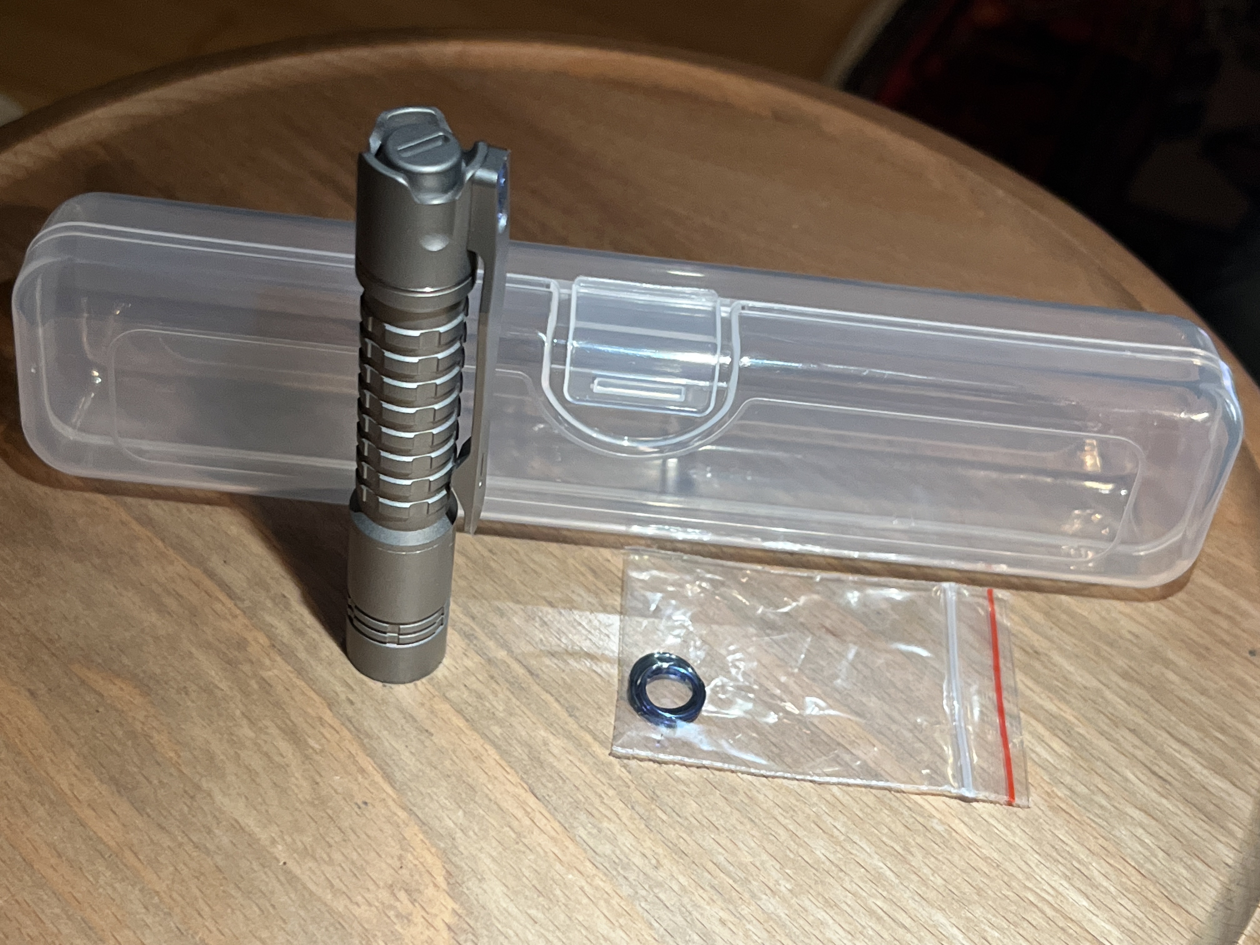

The newbie:
If you want fancy packaging, a detailed manual and a certificate of authenticity, Rey is not your boy. You get a plastic box, a couple of spare O-rings and a small anodised split ring for use with a lanyard.
In terms of what's new (presumably as against Mk 2, which I don't have) the Reylight web site says:
-- Reverse clicky switch, classic and great clicking feel is back again. [Mk.1 is also reverse clicky]
-- Thinner tailcap allows more room for finger.
-- Ti anodized screws.
-- A more fitting cnc clip with the tailcap. Barely a gap, and better tailstanding. (There is still a minor gap with the smooth body, because it's slimmer than frag one.)
-- New Ti washer that has a keyring hole.
-- Bigger inner diameter, for 10440- USB-C battery. [A 300mAh USB-C 10440 battery is available as an option, the light ships as standard with a 350mAh 10440 that needs a battery charger]

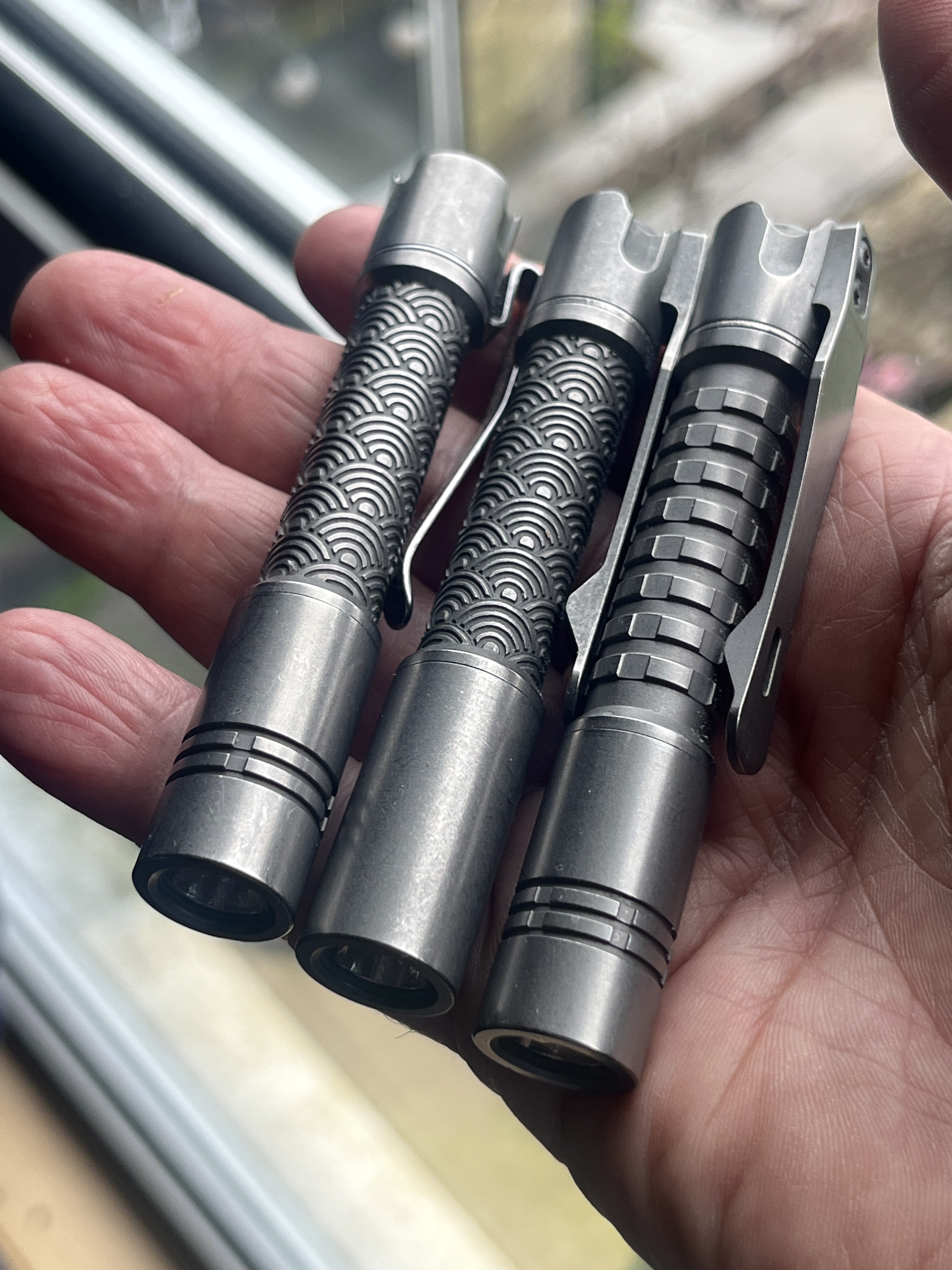

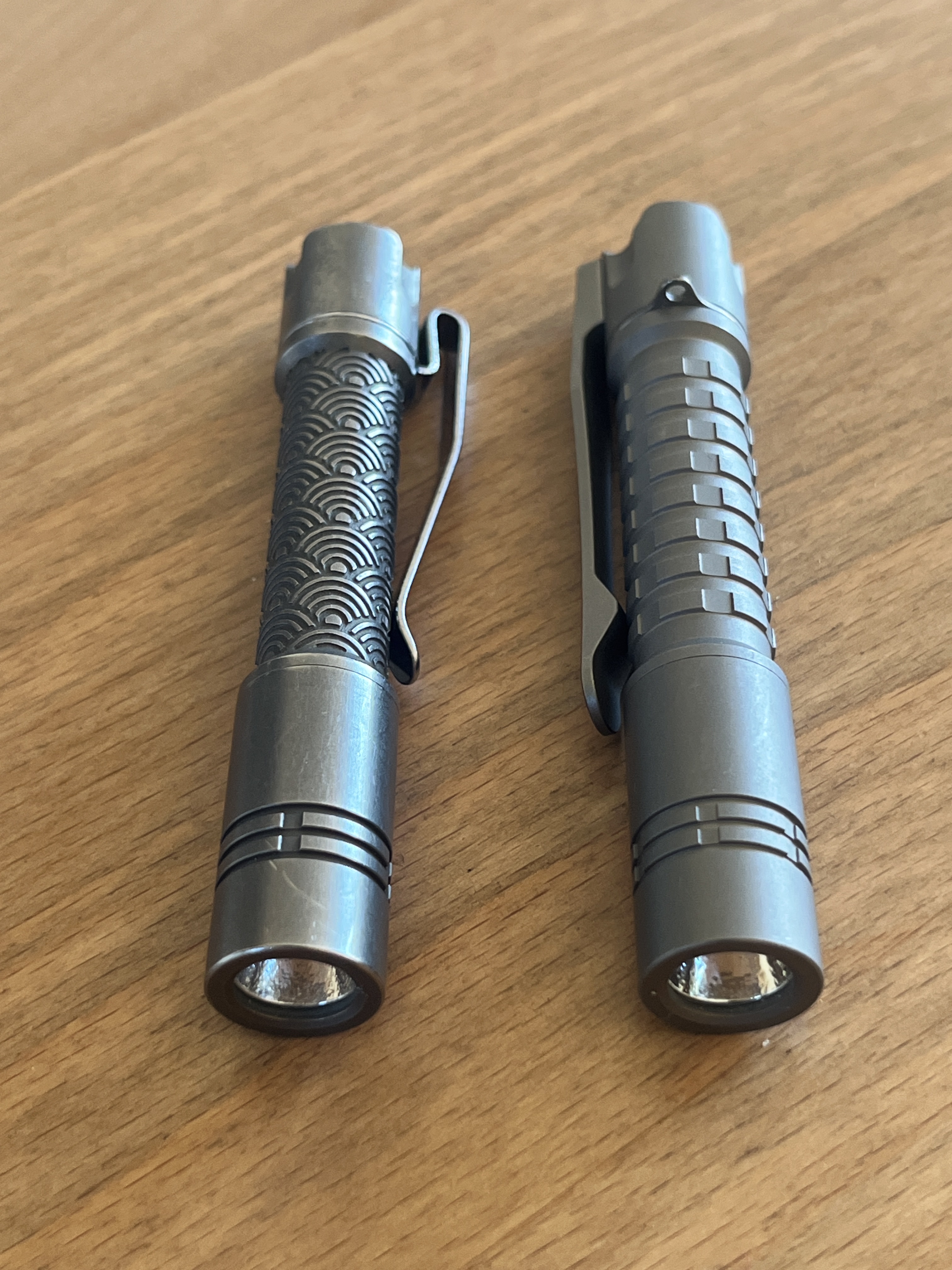

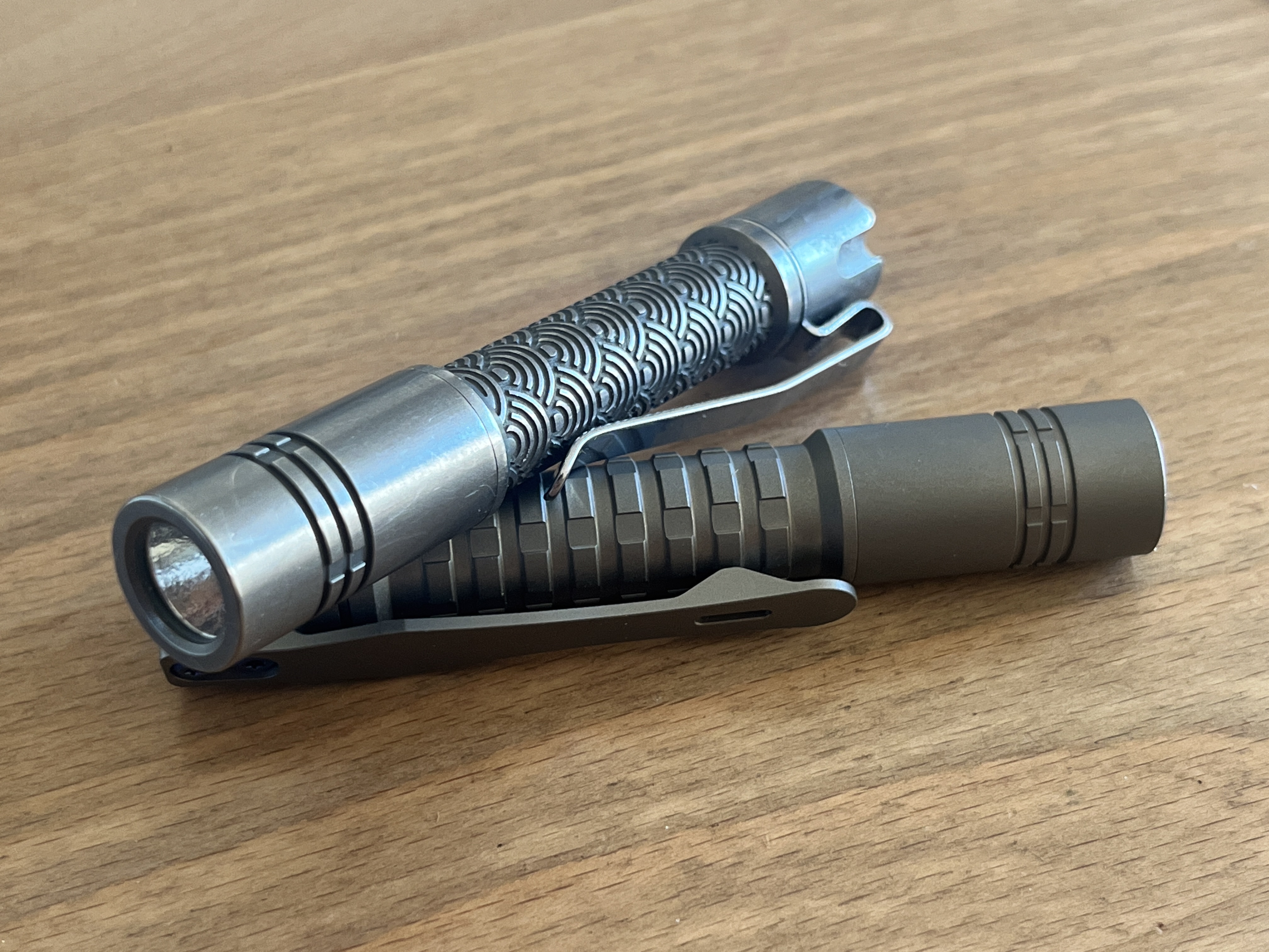

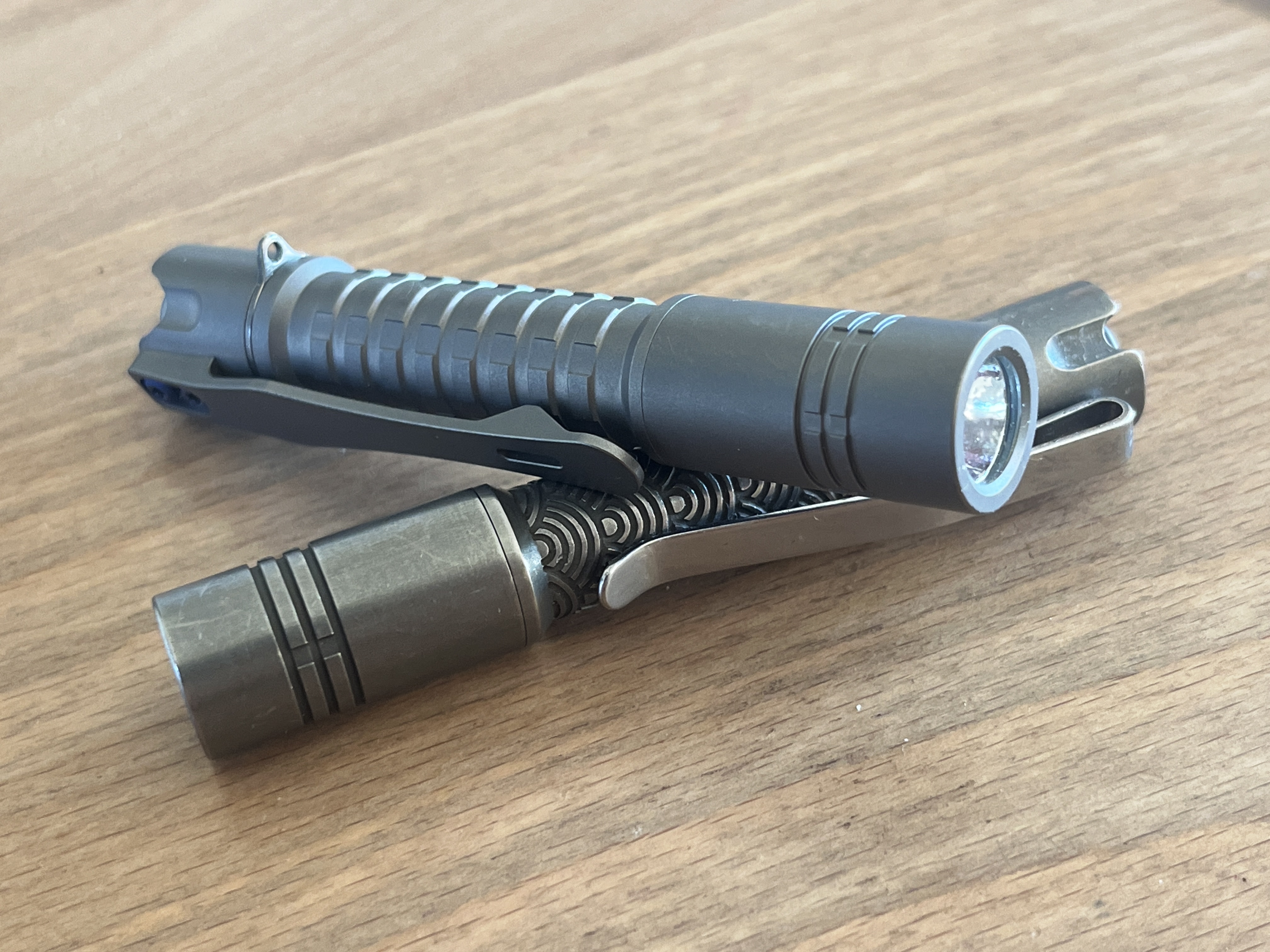

Family portraits:
Functionality appears to be the same on both versions. I don't have equipment for measuring light output, so I could only gauge that using the subjective measure of my eyes. I initially thought that the output was very slightly higher from the Mk.3, but having swapped batteries between the lights I think this is likely accounted for by the difference in output from the old battery from my Mk.1 (which has probably been charged and discharged around 200 times) and the factory-fresh battery in the Mk.3. I suspect that the pill in both versions is identical.
The visible changes to the light are the re-designed tailcap, which causes the Mk3 to stand a couple of millimetres taller, and the use of a very substantial titanium deep carry clip instead of the thin springy stainless steel clip on the Mk.1.
The new tailcap is an improvement. It makes clicking the button easier. It was not difficult before, but this feels noticeably better.

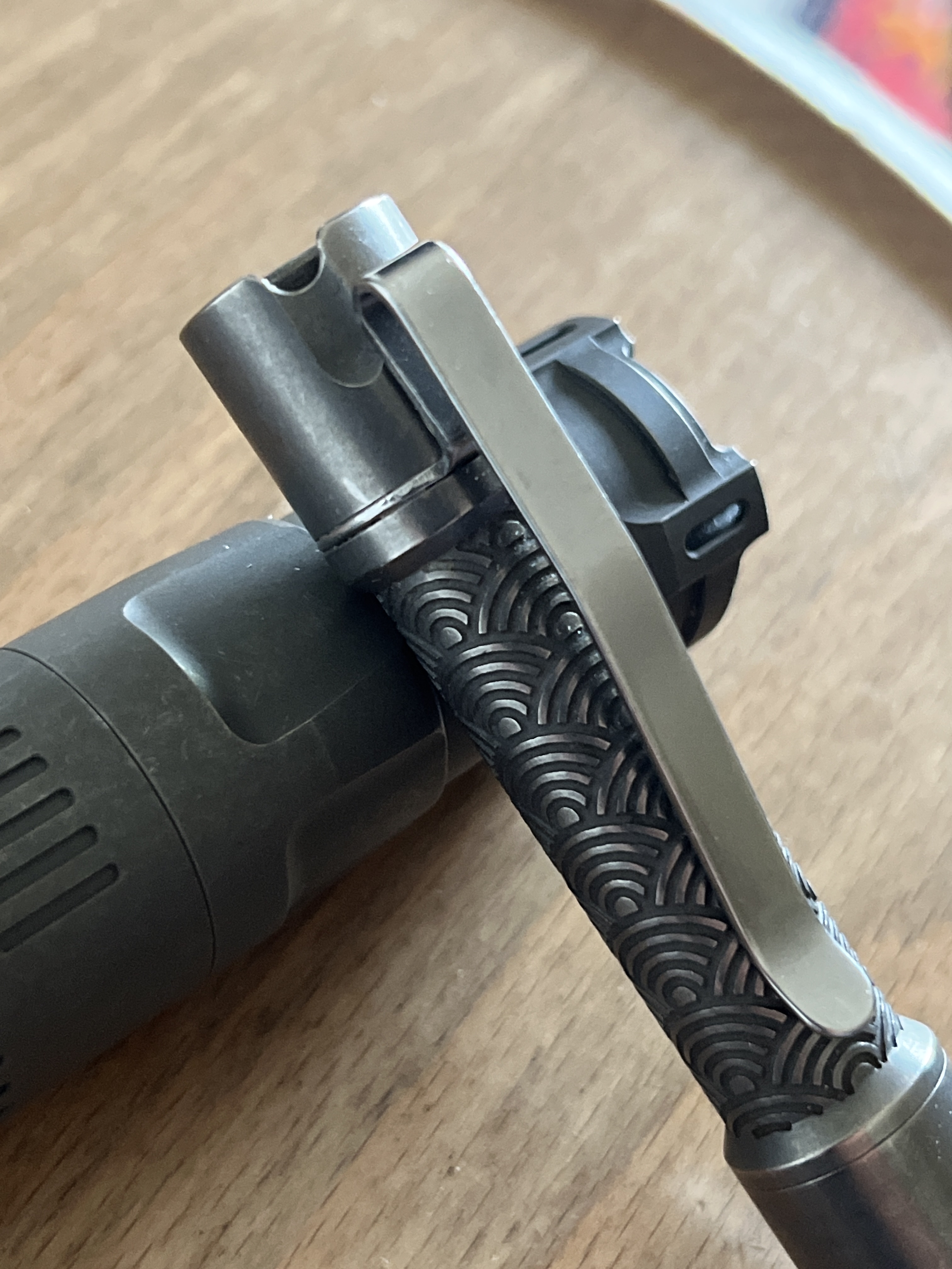

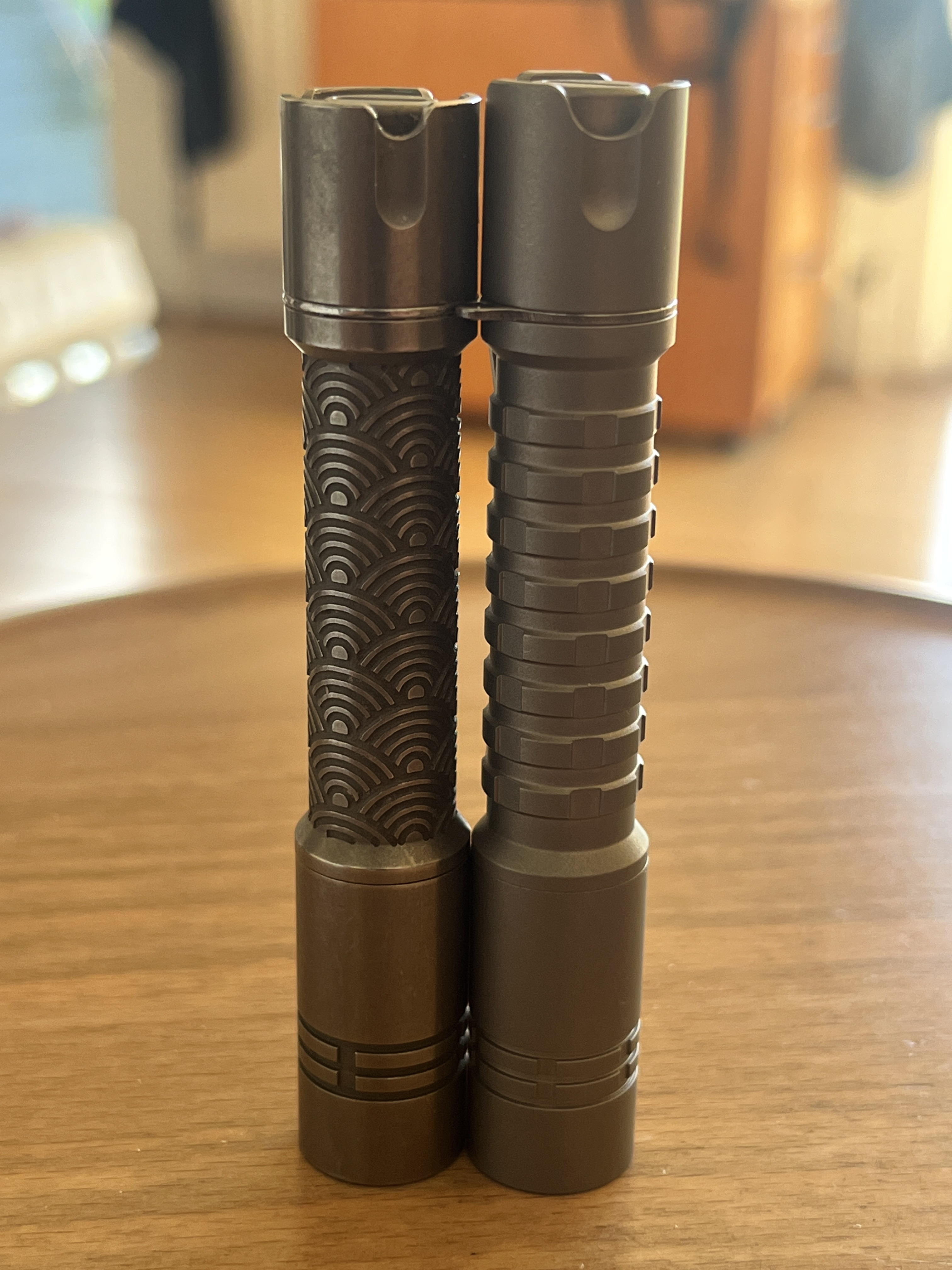

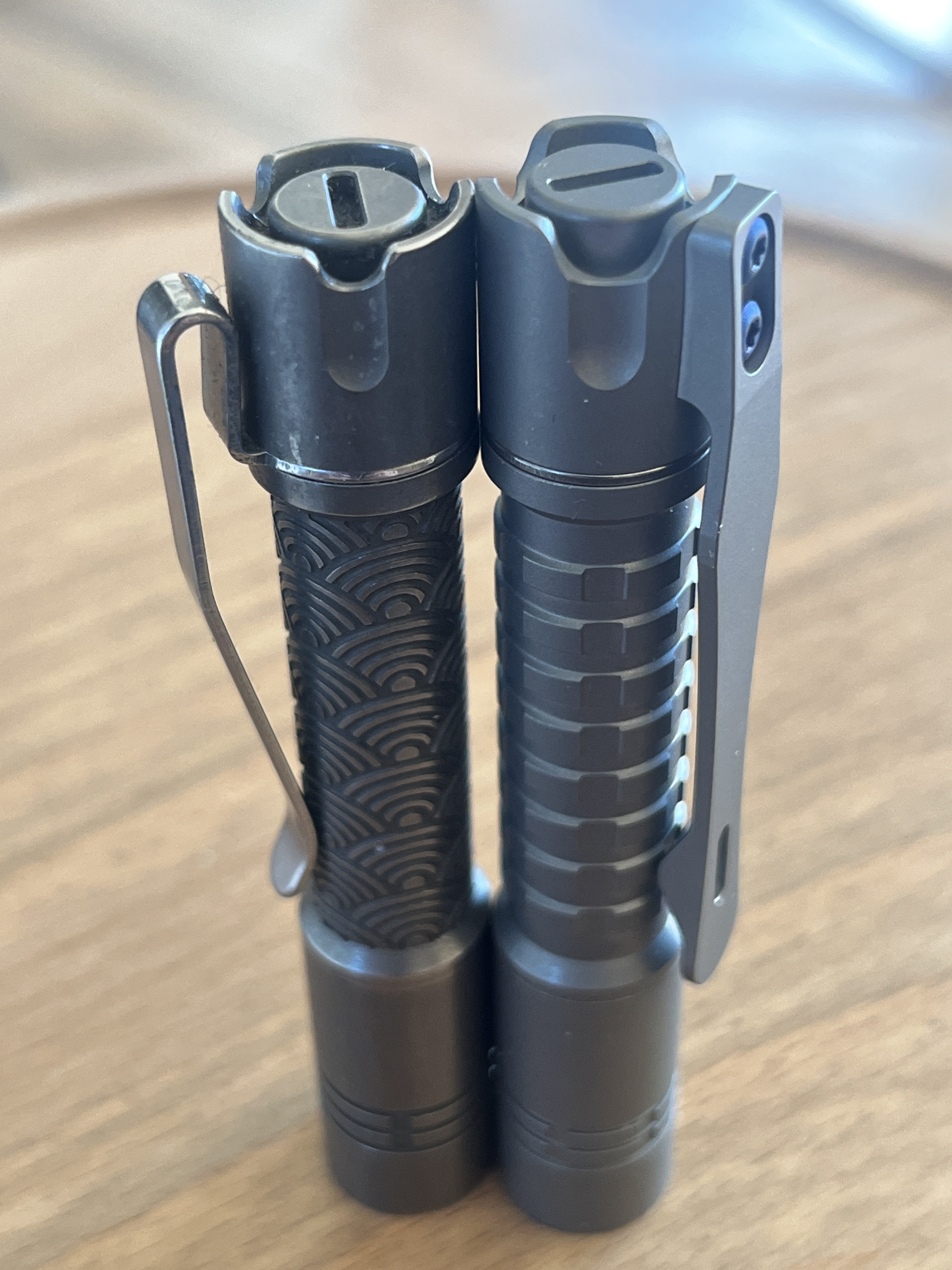

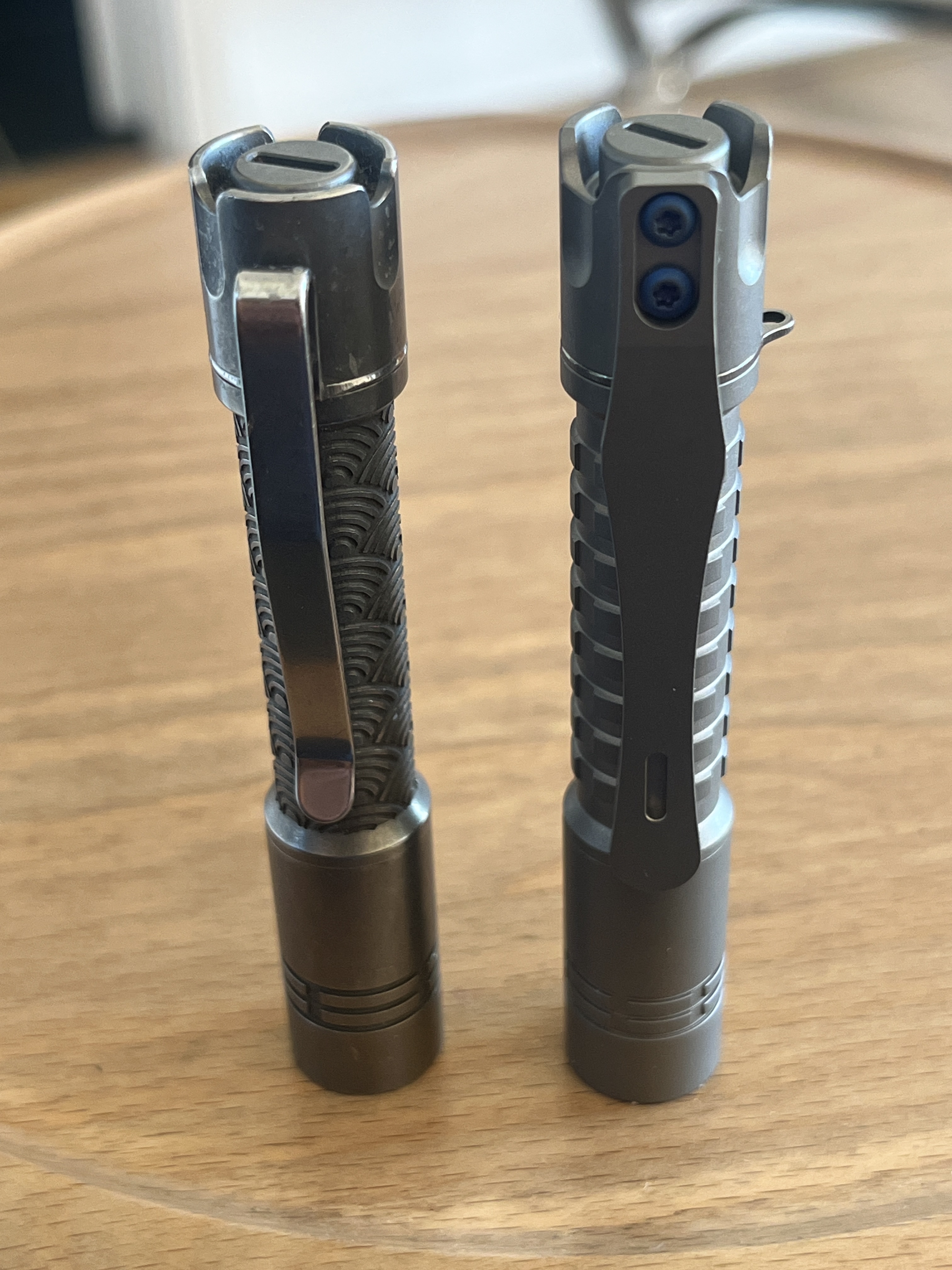

The new clip is something I have mixed feelings about. When I got the Mk.1 RPM I certainly thought that aesthetically the shiny steel clip did not work with the matt titanium of the flashlight, and I felt that a matching titanium clip like the one the Mk.3 has would be a big improvement. Now that I have what I wished for, I'm not so sure. Partly because the steel clip on the Mk.1 no longer bothers me at all - I'm used to it, and it's superbly functional. The contrast with the body of the light is also less jarring now that wear has made the body semi-polished rather than fully matt. The new clip on the Mk.3 does look damn good to my eyes, and its massively robust construction just adds to the impression that Rey engineers torches of tank-like solidity that will outlast their owner by centuries. But in terms of functionality there are two downsides. One is that the clip is so strong that it takes a distinct effort to get it to allow access to the fabric of your jeans pocket (once situated though, there are no realistic circumstances in which it will accidentally come off). The springy steel clip on the Mk.1 slides easily into place, and is still decently secure. Possibly the new clip will get easier with wear, when my grandson is using the torch.

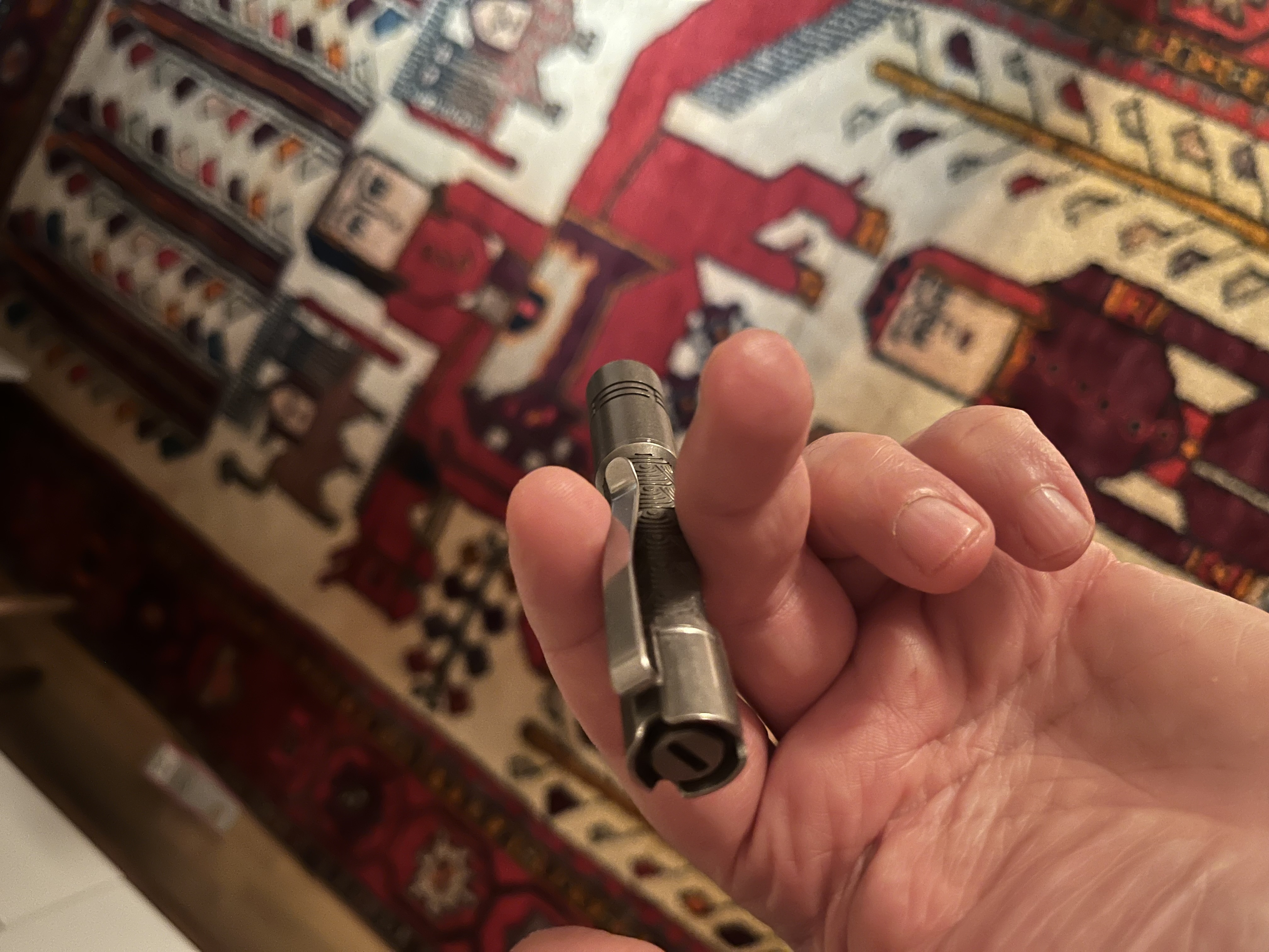

The other downside is that, as can be seen here:
the design of the new clip means that the light will not sit as deep in your pocket as the Mk.1 - it will stick up about six or seven millimetres higher. This can cause more friction with your hand / wrist when moving it into or out of your pocket. I don't view this as a huge deal, but I do prefer the way the Mk.1 lies deep.
The frag pattern is probably as good for gripping as the seigaiha, and makes the midsection of the torch feel a bit thicker and more robust. It also feels very satisfying in the hand when you grip it. Because of the frag pattern, the new clip and the taller tail cap the Mk.3 overall feels as if it's a bit larger and more substantial than the Mk. 1, though this is more an impression than a reality. The difference in weight between the two is just 3 grams (44.8g vs. 41.7g by my scales).
The titanium washer between the tail cap and the midsection of the torch has a hole to allow you to put the split ring on and attach a lanyard.  If like me you are not going to use this, it is a minor irritation to have it sticking out.  I feel that a spare washer without the keyring hole ought to be included. Having looked again at the Reylight web site after receiving the light, I note that it is possible to buy a plain washer as an add-on part for $2, and I just missed this when placing my order; I will get one next time I buy something. Whilst I may grumble, at around $70 the RPM Mk.3 represents great value.
In summary, I'm not yet sure whether I like the Mk.3 better than the Mk.1 - will probably be better able to say in a few years. Regardless of that, it is an awesome little thing and I can't imagine that anyone who is in the market for something like this would be disappointed by it.
« Last Edit: October 11, 2025, 01:08:36 AM by fullbreakfast »
