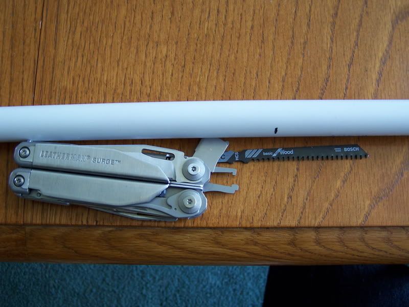

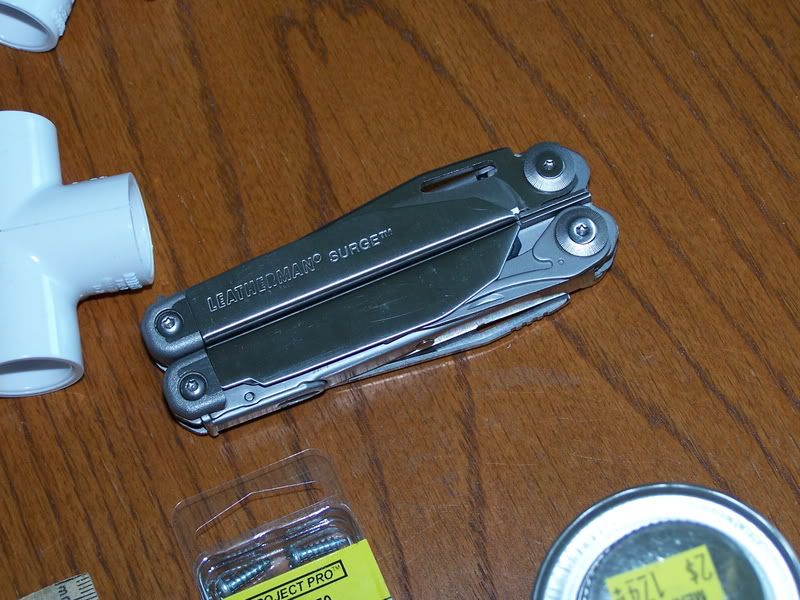

I went to my local Menard's store and picked up everything I needed.  I decided to use the LM Surge to help with this project because of it's ability to use t-shank blades.
The components were all readily available and easy to find.  The drill bit is used to drill the holes in the pvc to mount the background holding screws.  I had intended on trying to use the Surge to hand drill the holes, but it ended up being harder to do than I thought.  (I need a bit adapter :) )
I picked the Surge for this project for one reason only.  The t-shank blade adapter.
The t-shank blades were a little loose in the adapter.  It's wasn't noticeable while cutting, and the blade cut thru the PVC pipe very quickly.  Even with the short blade and short stoke used, I didn't have any trouble with making the cuts.
