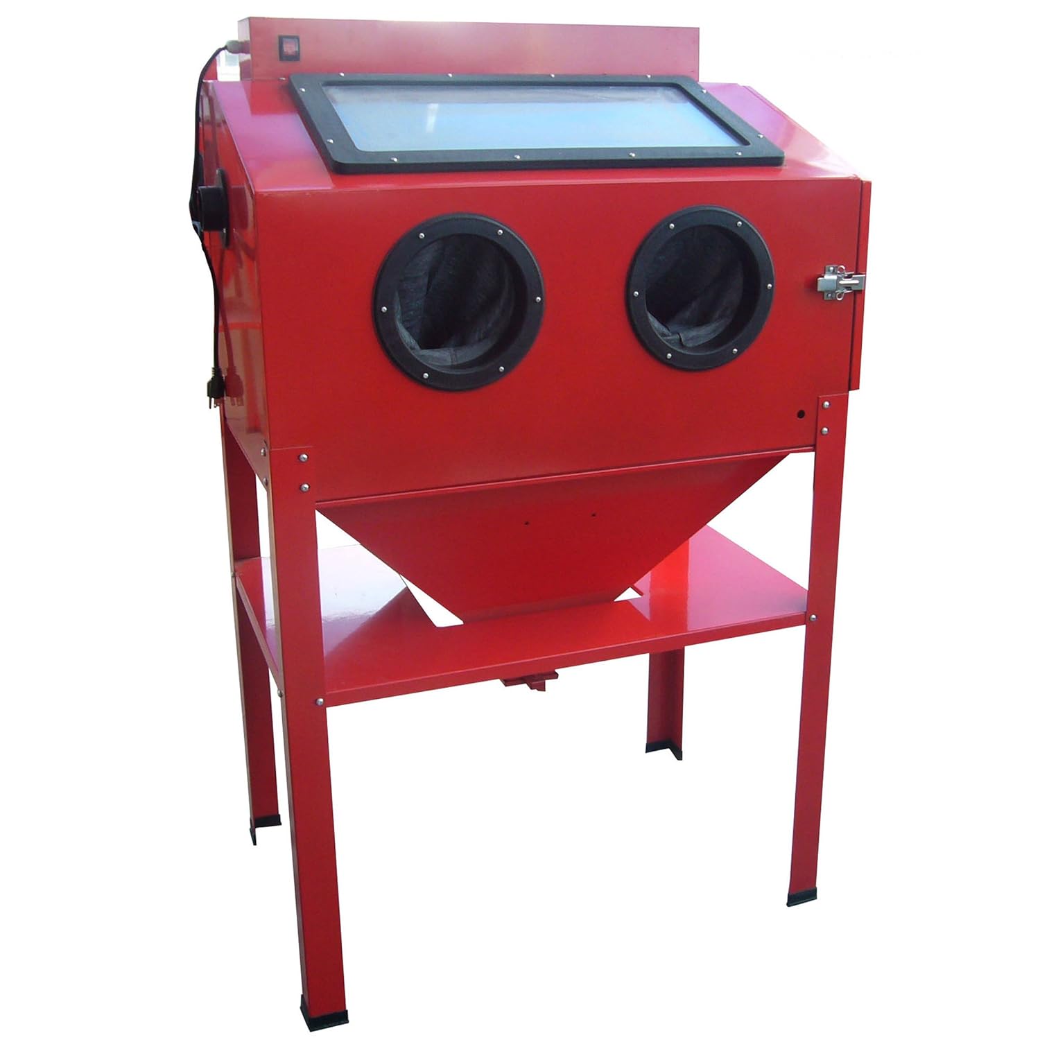

Ok, time for equiptment again.  Im tired of waiting 24 hours for the tumbling to get the matte finish on the Ti, so I need a blasting cabinet...
Got this on the way.  Amazon had them for a decent price.  :D
Now I gotta get a compressor that can do 12 CFM at 80 PSI.  I think those are going to be more than the blasting cab is, and it needs to be 220 volts so I'll have to run a line to the shop for that.  I have a spare 220 breaker though so that shouldnt be a big deal, the ceiling is all open from teh breaker to the shop.

New tools!  Always exciting!
That blasting cabinet looks like a good piece of equipment and good luck with the compressor search.  I started down a slippery slope when looking for one for my garage.  Ingersoll Rand has some nice stuff, but I actually got an older Speedaire one for a fraction of the cost on Craigslist.  I only wanted a 20 gallon tank but the quality of the motor, regardless of the tank size, is what you are really after.  I ended up with a cast iron, double piston setup with changeable oil.  Those oil-less ones are short lived and I don't believe would be up to your task.  Then when you start looking at hoses and fittings, it starts to add up too.  There are some pretty nice GoodYear hoses around unless you are hard lining it (although, i'd still be tempted by a section of hose so that it was at least a little moveable).  Also, I've read that using a slightly larger line helps keep your pressure constant, so I went with 1/2" line with 3/8" fittings.  For fittings, there are three standards that I ran across and I ended up getting mine all in Universal format so they will work with the other two main types, which won't work with each other.
This is like the compressor I was able to pick up for $150 in perfectly functioning order. 20 gal, 3 HP, 10 CFM @ 90 PSI.  No problems so far in limited use:
But that is some of what I found when I was searching.  You may have more experience on the subject already and I'm sure there are others around who can give you better guidance.  Anything I've stated may actually be completely wrong so take it with a whole cup of salt.
Good luck with your search!

Ya the compressor Im not exactly sure what I need yet, but Im sending out some feelers for used ones right now.  For the amount of blasting I'll be doing I dont need something too hard core that will be running all day or anything.
Im not at all concerned about noise, since it wont be on all the time either.   Really its just going to be for glass bead blasting of Ti.
That one you got for 150 looks sweet. I hope I can find a deal somewhere.  :D
