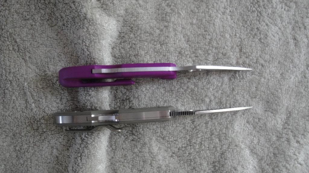

us Offline Gadget Guy
    • Posts: 4,503
Re: FRN handles for EDC knives
Reply #8 on: November 09, 2009, 08:09:20 AM
I like them too, but I would much rather have G-10 on my knives. On a budget knife I don't have any problem with FRN scales.  :tu:
Curious as to why you prefer the G10?
G10 may be somewhat tougher than FRN - at least it touted to be tougher - but it is also a lot heavier.
Even on metal liner knives, G10 scales can add a lot of weight compared to FRN.
The Byrd lineup of knives offers models with stainless liners equipped with either FRN or G10 scales.
G10 Cara Cara, for example, is a couple of oz heavier than the FRN Cara Cara.  The G10 may be somewhat stronger, but I've never seen any tests directly comparing the two knives.
I have a large hand and I get a much better grip with G-10. I think it adds very little extra weight to the knife and I think it looks a little better too.
Nice looking Emerson there.
I agree that G10 makes a better looking handle than FRN.  However, let's compare weights and prices of popular models.
Cara Cara G10:
http://www.knifecenter.com/kc_new/store_detail.html?s=SPBY03GP
Cara Cara FRN:
http://www.knifecenter.com/kc_new/store_detail.html?s=SPBY03PBK
FRN scales - 3.8 oz
G10 scales - 5.6 oz
An increase of 1.8 oz.
Going from FRN scales to G10 scales increases the weight of this knife by nearly 50 percent!
I bought the G10 Cara Cara because reviews said the G10 was grippier and sturdier.  Now I sort of regret not getting the lighter FRN version.
G10 may be sturdier, but I hardly think G10 is grippier than a well textured FRN handle.
Heck if I have to worry that much as to how much my knife weighs I would buy an all ti knife.  ::)  You like FRN which is cool, but it seems silly to compare FRN to G-10. FRN is a budget material plain and simple. I have plenty of FRN knives and they are great, but I still wish they all had G-10.  :D

Like I said above, I've never seen a comparison test of the FRN and G10 versions of Cara Cara.  All Cara Cara versions are rated "Heavy Duty" by Spyderco, IIRC, but I'd guess the G10 handle is stronger because G10 is stiffer than FRN.
That ranking is one step below Spyderco's top rating: "MBC" = Martial Blade Craft, which is reserved for their very toughest folders like Chinook for example.
I do like the G10 Cara Cara, but it's too heavy for me to EDC.  The lock and handle of my G10 version feel super heavy duty indeed.  Feels like this knife would be nearly indestructable in any non-abusive task.
Let's look at another popular Spyderco model that comes in both FRN and G10 versions.  Comparing the FRN Dragonfly and the new G10 Dragonfly:
FRN version is just under 1.2 oz:
G10 version is just under 2 oz:
Again, the G10 version is about 50 percent heavier than FRN.
Note that the G10 Dragonfly actually weighs about as much as a typical 3-inch bladed FRN folder.
More comparison pics:
Clip comparison:
Thickness comparison:
I own a FRN version Dragonfly which I love, but not the newer G10 version.
The G10 version is a better looking knife IMO, but is also substantially heavier and way more expensive than the FRN version.  The G10 version is probably stronger, but I'm not sure how important that is for a smaller knife like the Dragonfly.
Some people prefer the FRN version for its lighter weight, while others actually prefer the heft of the heavier G10 version.
(These Dragonfly pics were posted over on the Spyderco forum.  If the original poster objects to these pics being posted here, please notify me and I'll remove them.)
Clip comparison:
Clip comparison:
