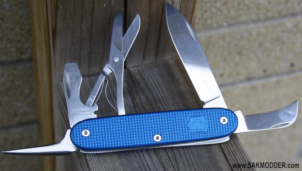

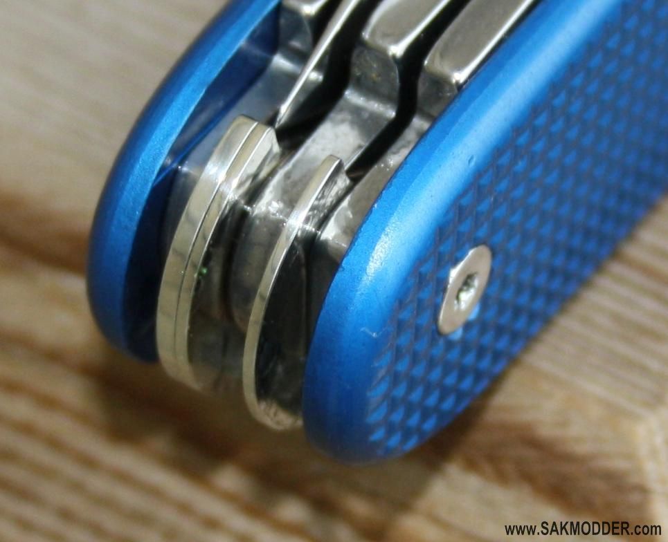

And a little more blue again today! :D  This time a rancher with scissors.

One custom beauty after another  :tu:
Here are my alox customs done by Robert /Syph007 so far:

Cool I think thats the most of my customs Ive seen together!  Eventually I will have to start collecting my own mods.  The nice thing is I get to build lots of different ones that people request so I get to see what configurations I'd like for myself.

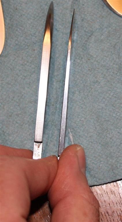

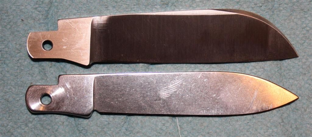

Check out these beauties that arrvied today!  A few custom made SAK blades in 154cm!! :D :D :D
Stock 93mm blade at the bottom of this pic.
We have some spear point, clip point and sheepsfoot.
Check out how thick these are!
The idea here is that these will go to making some old timer whittling type knives, but with SAK parts and one heck of a big strong beefy main blade.  I think a big sheepsfoot down the middle and then awl and pruner or small blade along the side opening from the other end.
Modding thread : Here

Admit it, you got tired of sanding down your thick springs. :D

Ha, you dont know how true THAT is.  I actually had a buddy at a machine shop surface most of my springs to scissors thickness as the by hand method was crazy.

Wow that's thick! JR

LOL ya.  I can probably double as a pry bar, evac tool SAK. :D  These arent heat treated yet, so I could thin one, but I kind of like how they feel.  Thats not a SAK... THIS is a SAK!

I like the blade shape of the ones on the far left and far right (both ends).  Either one would look cool on an alox!
Got any prices for them? :)

I have no idea what they will end up costing, this is all new to me.  It's mostly a test to see how I like a custom blade, and trying heat treat and different shapes out.  Someday I really need to learn to make blades too, but Im not there yet, so these were from a trade for a SAK custom from another blade maker.

Cool blades! Robert, what type of steel and who (if it can be disclosed) made/makes them?

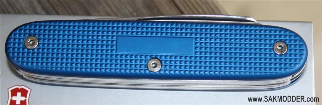

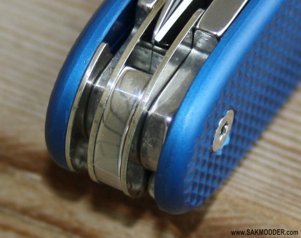

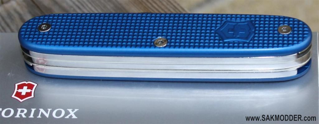

I'm almost caught up now on customs for others so I got to work on one for me last night.  Cadet II with scissors.  I have a few 84mm mods I want to make and collect, and this was first.  Next is a regular cadet with scissors in red, and backside awl.  I just about have that one fit up.

How's the backside tool working out? Do you think it would be possible to put a corkscrew on either a Cadet or a 93?

The one set of alox scales I had made up with the corkscrew cutout, I messed up badly and didnt get to actually try that knife out.  The scales are so thin there is barely enough room to have that hidden pin.  I might just make some 84 Ti scales to gain some strength and try again.

Why not make it visible and use screws like on the others?

For Ti I could, but alox the screw position would be right in the shield logo.
