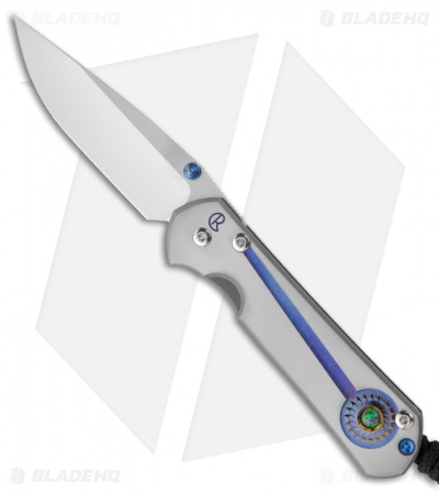

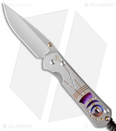

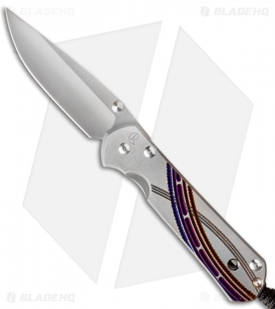

I had an idea and wanted to try today.  Make some grooves in a Ti scale, anodize the whole thing and then sand the surface leaving the inner parts still colored.  It does work pretty well, so I could make some interesting texture on Ti for grip or accent and color them.   Some interesting potential there for sure.   :tu:
I think a series of diagonal liner or X shapes would work well...  :think:

Hey that's awesome looking!!!!!!
- Robert
Quo Fata Ferunt
us Offline captain spaulding
    • Posts: 20,793
Reply #2768 on: May 23, 2015, 02:22:02 AM
Very cool! Reminds me of what CRK does.
